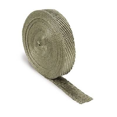

If there is room, DEI makes header wrap (offered by many of the FORUM vendors) that can provide a solution (temporary or permanent) that may be less challenging than moving the distribution block. You could wrap just the pipe(s) that are the problem or do the entire header.
http://www.jegs.com/i/DEI/186/010110...Fatj7Aod9TIAGg
Good luck... GUSTO

I just bought some at my local Advance store...works great! But you will also need clamps or some galvanized wire.
