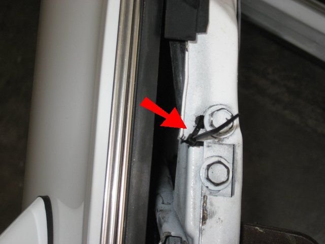

I ran into the problem of window not going down after my car was repainted and I reinstalled the remote sport mirror and cable. When I took the mirror and cable off, prior to painting, I was not aware of any hooks etc. used to hold the cable up and didn’t see any when I started re-assembly.
My solution was with the window up and the bottom access panel removed (that covers the electric motor for window), I could move the cable up to the top ledge of the side impact safety guard rail and let it sit there. With the joy stick end of the cable in it’s expected mounting position it seems to form a very taunt loop with the cable between the outside (on ledge above guard rail) and the inside of door. Especially when I rotated the joystick end counter clockwise to make sure the up motion of joy stick really made mirror go up. Just to be safe I added a tie strap to hold cable up high on the inside of door (see pic).
This was not very difficult to do. I left the excess on tie strap just for pic and then cut it off and everything has been working fine.
