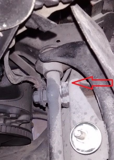

To awaken this thread and to not open one unnecessarily I have one question.
My upper arms have shims underneath. Seen on the pictures.
Is this "normal"? How to install the spreader bar in this case? remove some shims? Leave them?
There is very little thread left in one of the bolts because of the shims.
My car is a 71 SB.

I have a speed direct bar on my '78.
Take the nut off of the bolt (that your bottom picture arrow is covering), put the mount on there, reattach the nut.
Yes, shims are normal, obviously depending on the accident/repair history, how MANY shims is separate matter.
Move the ground (top pic) somewhere else and you'll gain some threads to put the mount on.

I did mine on the floor with a jack, take the tension off the control arm bolts. One side at a time. No need to remove the bolts, just the nuts. Watch you don't lose the shims.
13/16 nuts IIRC.
