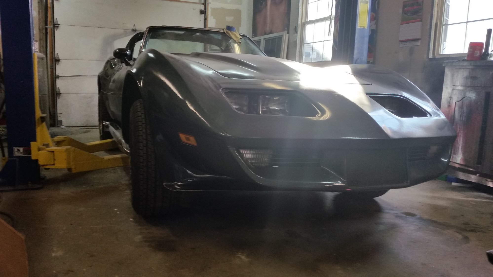

I molded in an 80-82 style rear on my 75
I also molded in the Indy style spoiler and 80-82 front, and used Sport Mirrors
I wanted the 80-82 looks, but had to have a flat rear window because I retro-fitted a removable window from a 69. I just had to have that window.
I
