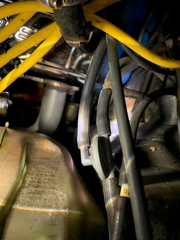

I have a drivers side headlight that stops mid way up. Both close ok. I am going to replace check valve as well. The one I have might be an old style or wrong type ? I cannot
seem to find this design ? Anybody ever see this type one ?

Swap them and see if the results change and move to the other side.
