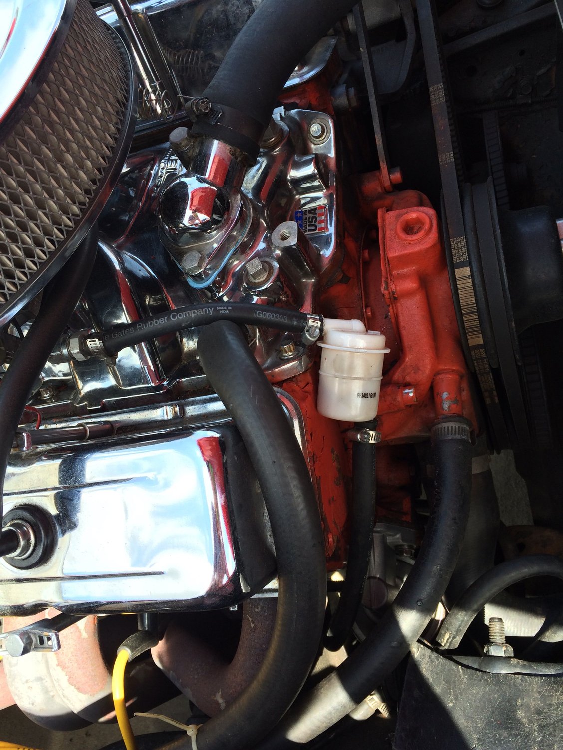

This might sound dumb but this little white thing is the only fuel filter we're talking about? Correct?

There are two rubber line that go from the fuel tank hard line to the fuel pump, they can kink if you don't have the 'Corvette molded' hoses.

I would loose that plastic filter ,its not really safe and many people have lost there cars due to them rubbing on the block and melting,cracking from fuel pressure ,,, once the gas runs down the block its game over

Yep, go back to the steel lines too.
