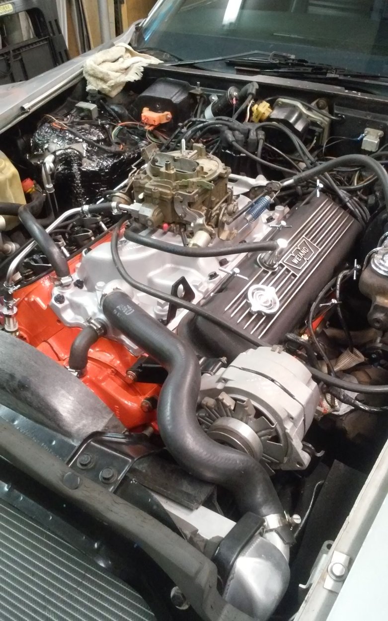

I'm putting this out here for any advice/comments. The start is a .30 over 454, with about 10.5:1 comp, balanced rotating assembly, I'm gonna use my 781 heads that has had a sorta recent valve job so they seal great now, Edlebrock performer 2 intake, Holley 800 dp, OBX side pipes.
What the plan is, maybe a three angle job and clean up the ports/bowls on the heads.
A Comp Cam kit, http://www.summitracing.com/parts/cca-k11-420-8, that includes almost everything.
Keep the Performer 2 intake and use the Holley 800...
As of now, the stock gears will be used, 3.08 along with the close ratio stock 4 speed.
So, any thoughts of how this set up may work? I have this cam selected for it's rpm range with the stock gears.

Old Aug 8, 2015 | 08:04 PM
labhound's Avatar
labhound
Posts: 361
Likes: 6
From: Jamestown Ohio
Its running now!!! I still need another carbon and a final tune.
