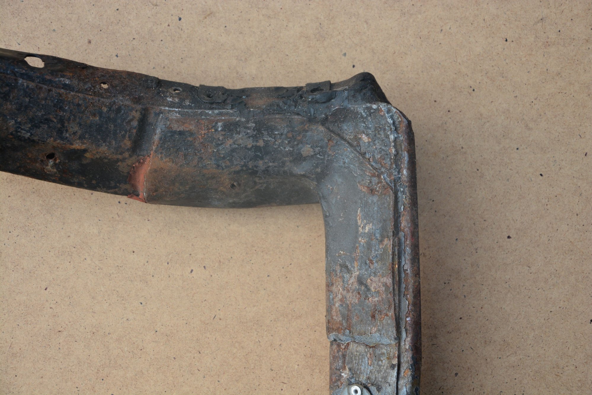

Here's an original right hand A-pillar, from a rust free 75, that we parted out years ago.
Just what mine looks like!
Thanks so much. Your info has been very useful.
Makes me feel better.
