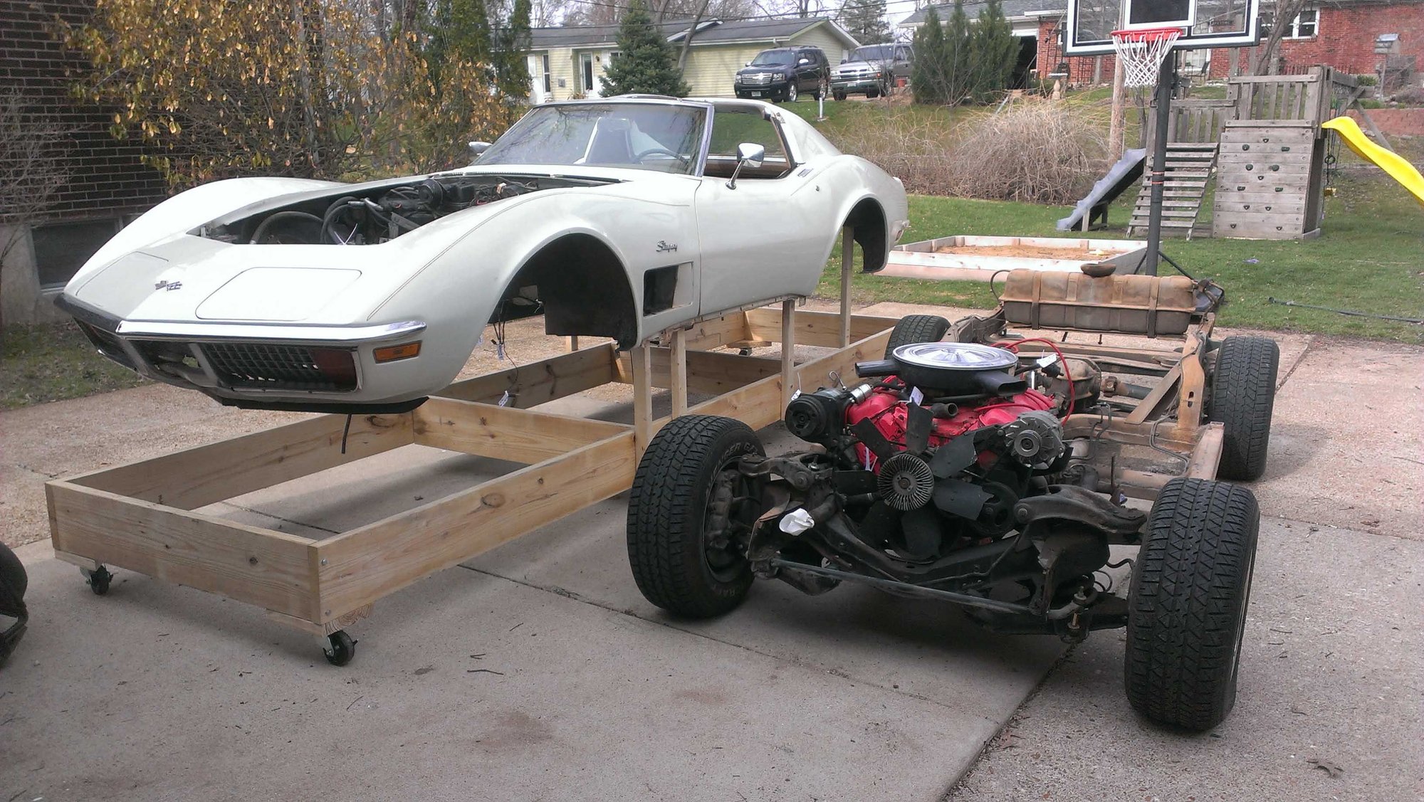

Just got the body off the frame of my 68, and all went well. Managed to get all the bolts out in one piece. Only little snag I had was I missed the seat belt brackets and started lifting the whole *** end of the car off of the floor. Good thing I over built my lift in the garage. Took a while to figure out what was happening because first it was getting caught on the passenger side trailing arm mount bolt. I backed that out and tried again, but no go. Then I remembered someone mentioned something about the seat belt mount so I dug around some more and found what they were talking about. Anyway the frame doesn't look too bad. I was surprised to find aluminum body mount bushings, was that an option or what originally came on these cars?

The frame does look to be in nice shape. What is your next step?

Next step is work on the body a little, had some rust on the driver's side sill plate support, and the driver's side floorboard cracked where you put your feet. Probably get it all primered and ready for paint, then spray it. Then I'll begin separating the suspension from the frame so I can get that all painted up nice. Then I am going to install a WC 5 speed, so I'll have to fab a support for that, freshen up the 327 and install some good heads on it, and then reassembly begins. In other words, I'll be busy for awhile. Started out as just a paint job, and morphed from there.

Who's dolly plan did you use for the body? planning a body off myself and need something that is mobile so I can take the body to FIL's garage to store out of the way and yours looks like it is pretty sturdy.

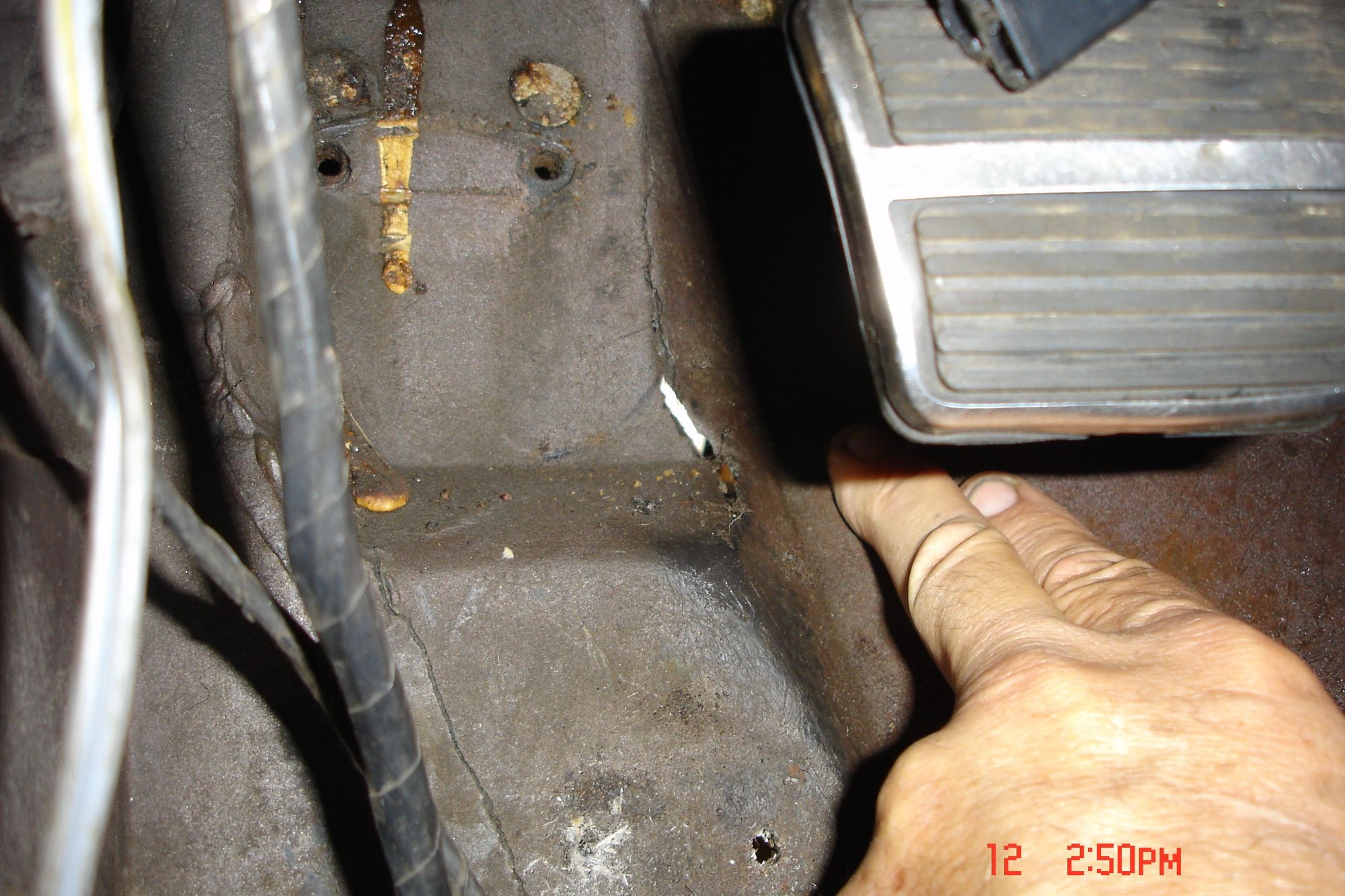

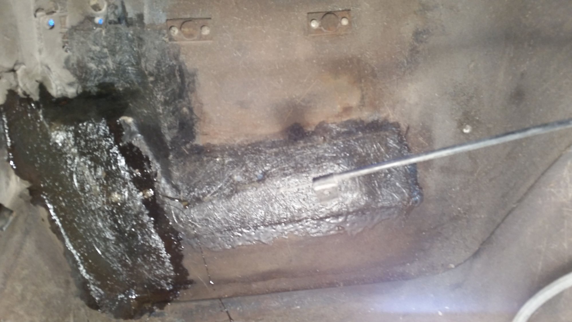

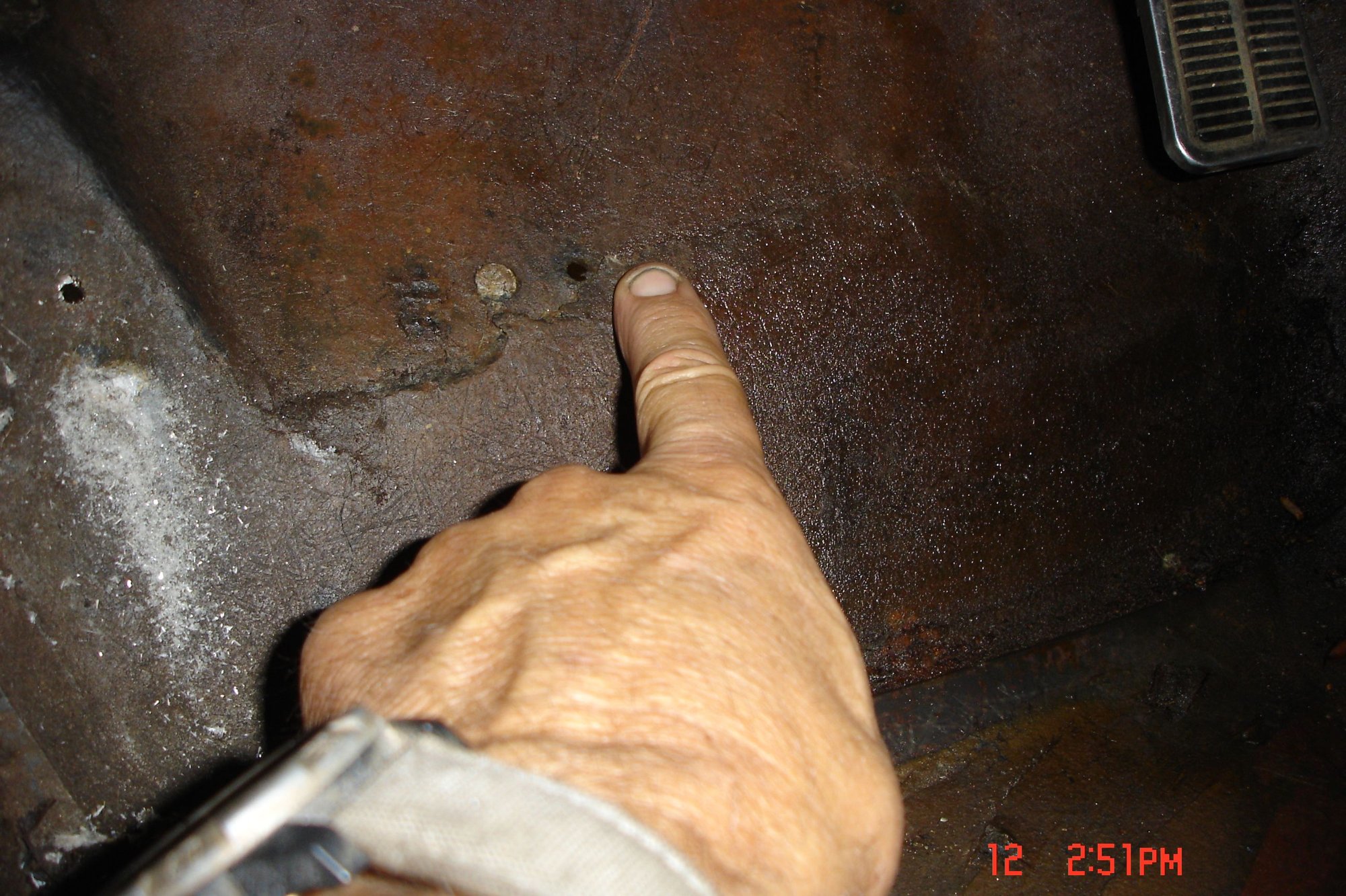

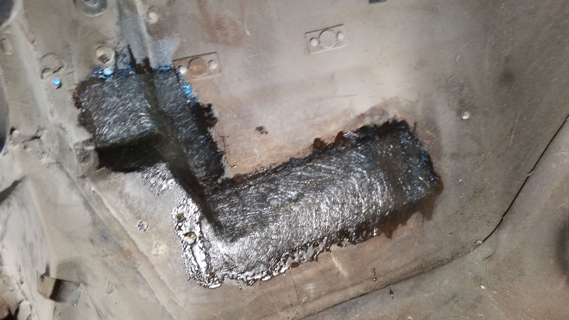

Hey Wrencher60 , my 69 also had some cracks under the clutch pedal area. Went ahead and cleaned and prepped the inside and outside areas and applied some matting to each side and that fixed the problem. If you do this pull the edges of the matting a little to give it an original look, instead of a straight line cut.
R
Hope this helps!!!

I used the plan with the 4x4 uprights and 2x6 frame with 6" casters from harbor freight, two in the front are spinners and two in the back stationary. Rolls real nice. I got the plans from this forum. They were really detailed. Only change I made was 2x4 uprights for the core support cause there is not much weight there. Casters were about 17 bucks each, so it only costs about $100 to build. I also didn't put the screw in studs on the uprights, but if you are moving it around quite a bit, it might be good insurance to have it bolted down. Mine hasn't moved around on the dolly and I've been crawling all over it doing some body work and wheeling it in and out of the garage.

dkleather had a post with this link on it, that has a lot of good stuff to know. http://lbfun/Corvette/Tech/vettetech.html. Under Body Frame tab there is a drawing for the C3 dolly by 'kaiserbud' that I used. I didn't use from the B-pillar back since I have a coupe and didn't need the back supported. So the whole thing is only 96" long, a couple of 16' 2x6's cut to length and a 8' 4x4 is all the lumber you need.

I used Alan71's dolly plans that uses vertical uprights at the body mount locations. Post #4 in this thread contains the plans. Made my uprights slightly taller to make working on the underside easier when that time comes. Also, used a lag screw in the top of each upright to help prevent the body sliding off an upright somehow. The pic below doesn't show it, but soon after added uprights to support the nose.
