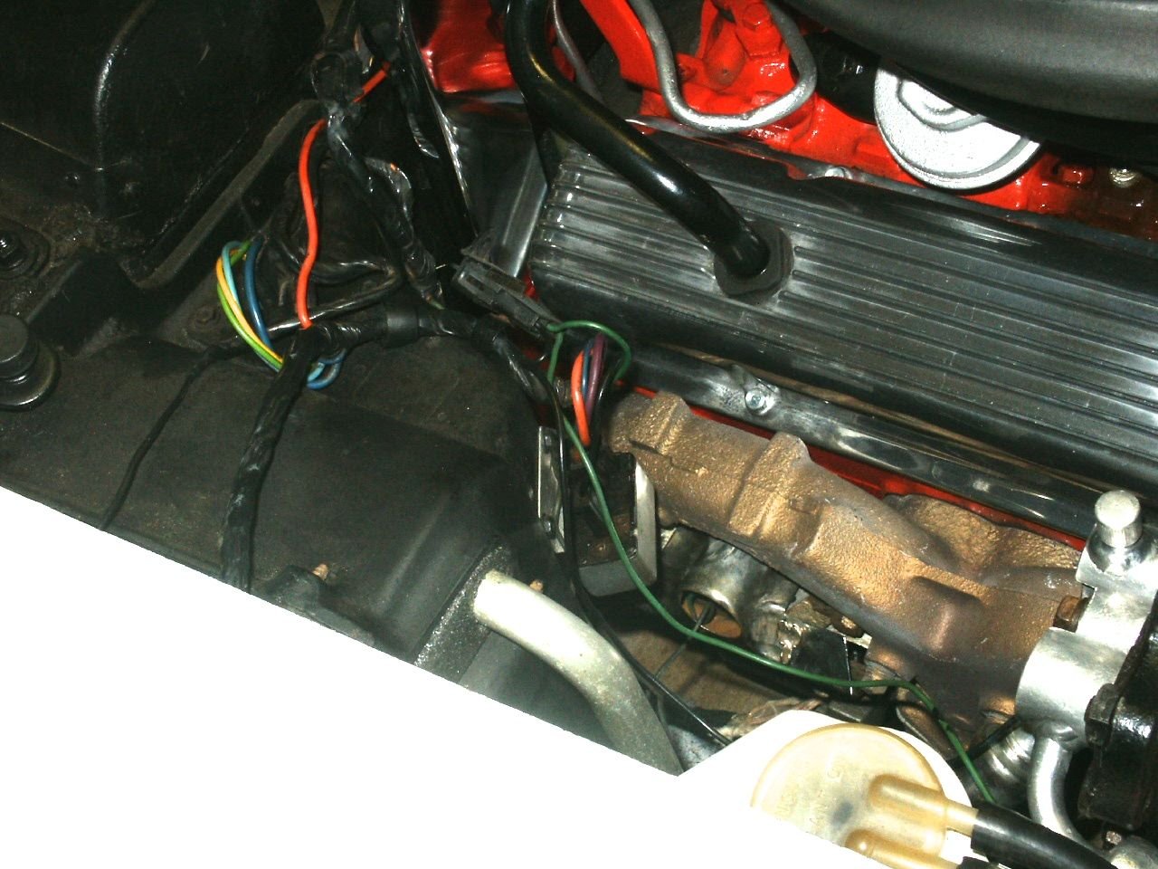

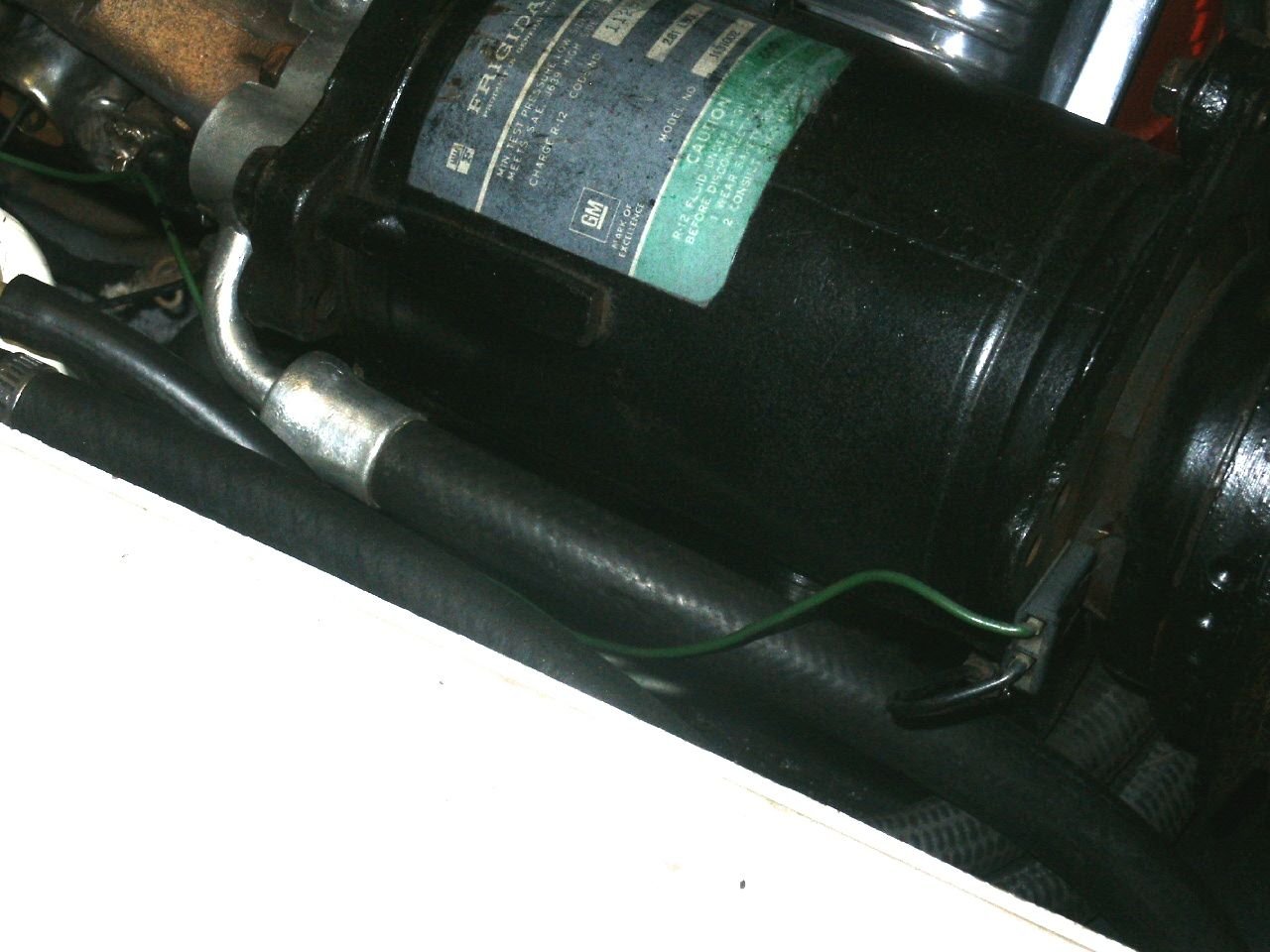

Where is that green AC wire supposed to run? It look stupid on top of the compressor, but i don't want to burn it on an exh manifold.
Doug
Here is the wire on my 73, hope you can see it ok.
Donnie

the extra green ac plug would go to a idle solenoid on transmission, ce be used to bump up the idle when compressor is engaged,
will have plug even if car never came with the solenoid. Installed on eon mine and it helped stabilize idle when running ac.
