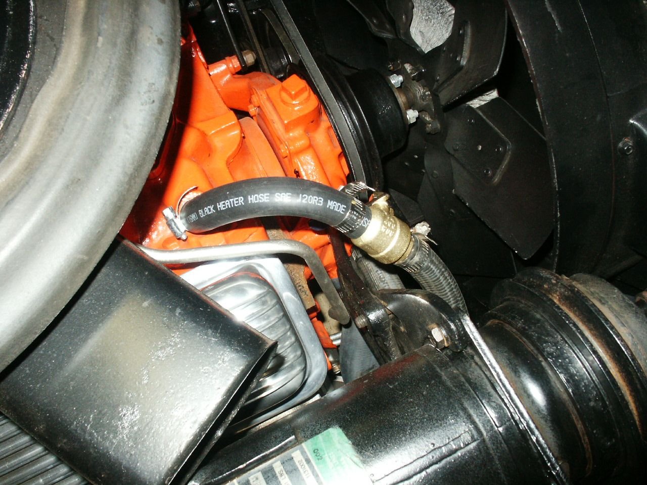

I am trying to figure out the routing for the top heater hose on a 72. The car has air and an AIR system. Any pics or advice?
thanks, Tom
Oops it is a base model
Here's how mine is:

On a 350 with A/C the hoses go under the A/C unit.

The molded hose i got from the good doctor is to short for that routing. Has anyone come across this problem and what did you do about it? Also there does not seem to be enough room due to the AIR pump bracket.

As in the diagram from the AIM (figure A), the hoses go under the air compressor, through the bracket under the compressor and to the outlet and inlet.
This is the bracket under the compressor.
The hoses under the compressor.
Then to the outlet and inlet.
Donnie
To heater hose
