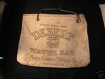

How about hanging one of these in front of the radiator?
Good luck... GUSTO
(long time Yuma resident...)
