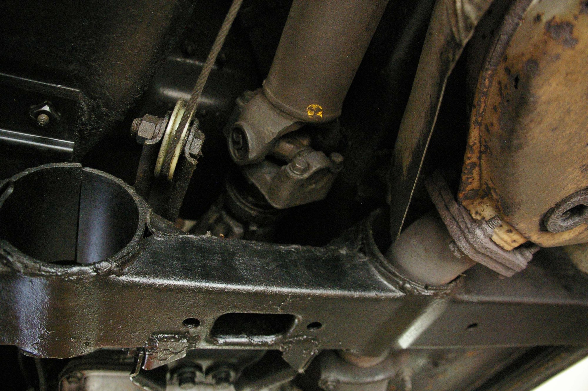

When you're done with the balancer you might want to get the exhaust pipe off the crossmember hole. The exhaust resting on the crossmember will cause vibration also.

Originally Posted by gearbreaker
when you're done with the balancer you might want to get the exhaust pipe off the crossmember hole. The exhaust resting on the crossmember will cause vibration also.
