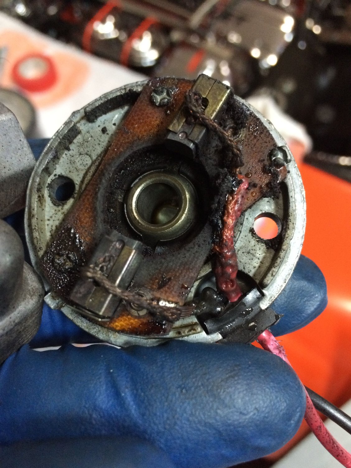

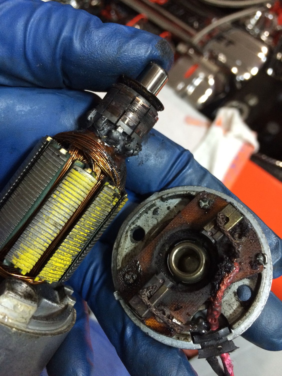

Old Jan 10, 2016 | 11:15 PM
  #40
retrodude's Avatar
retrodude
Joined: Nov 2009
Posts: 128
From: Leesburg VA
finally fixed !! After replacing the whole electric system I found out that the Holley Red Electric fuel pump was burning up inside itself. The pump only has about 50 to 60 hours total run time. Thanks again for all the great replies!!
