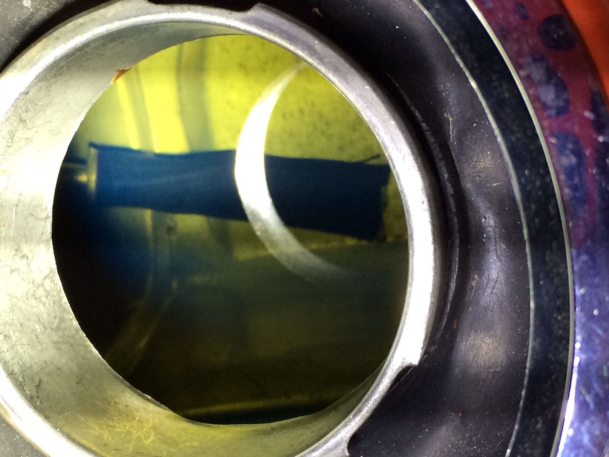

Those are all good ideas, I looked at the sock, should it be totally round? Is it necessary if I have a filter down stream? I'm thinking I can cut it off for now to see if it fixes it.

From: Leesburg VA
Old Sep 7, 2015 | 10:00 PM
Big2Bird's Avatar
Big2Bird
Joined: Dec 2006
Posts: 8,837
Likes: 1,028
Originally Posted by retrodude
Oh yeah. It's dying. You may still have an ignition issue, but that sock is collapsing.
