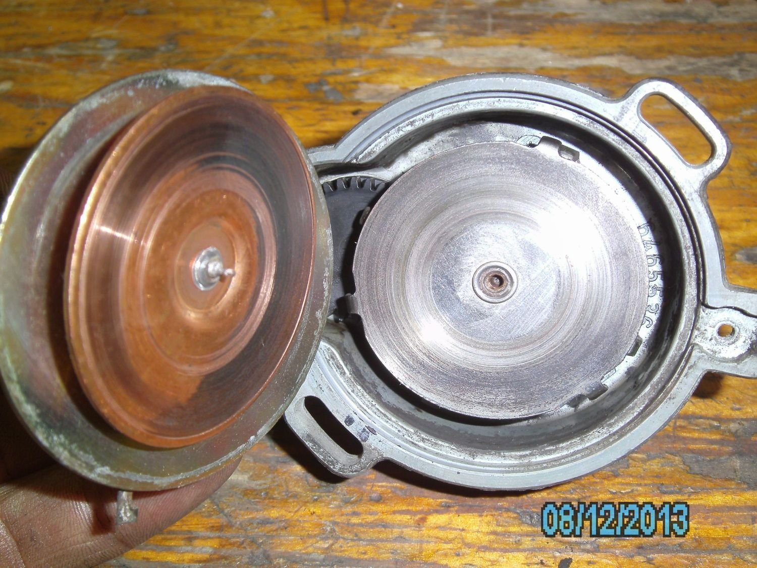

Mine did the same thing. I took it apart and cleaned it up. Worked again for a little while then started acting up again. Finally just replaced it with a re-built unit.
How it looked initially.
Then after buffing with a Dremel buffing wheel and Polishing compound.

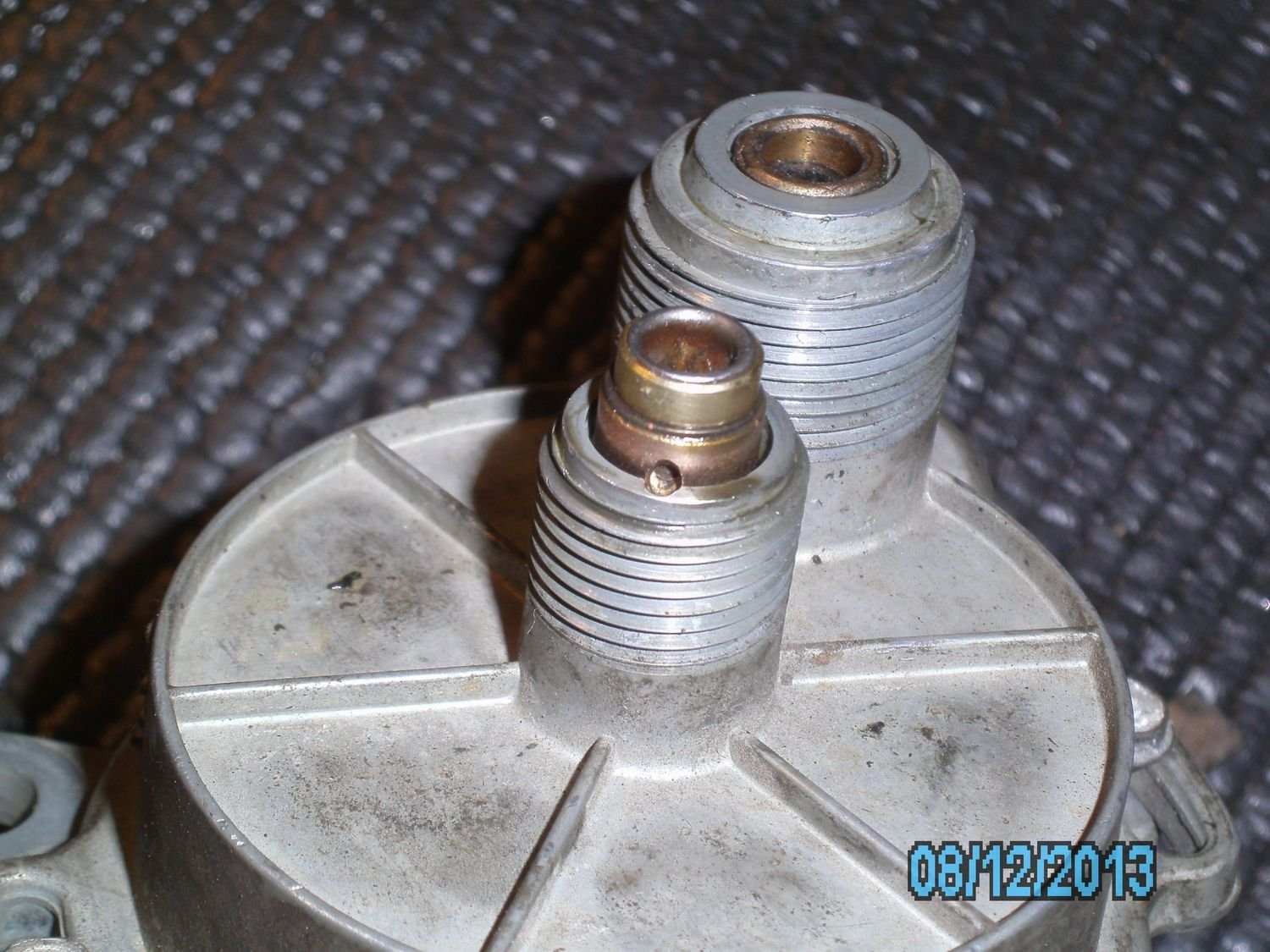

This drive was squeeky and not well lubricated so I drilled a small hole to intercept the bushing for lubrication.

REELAV8R, thanks for the great pix on this thread. I've got mine apart now and am curious if you used any lubrication on the plates after you buffed them, like a dielectric grease. I assume there's an electrical connection between the 2 plates as they rotate against each other... correct?

I did not use any grease. I think it's a friction connection if I remember right. There is a magnet and it sandwiches the copper plate somehow. I don't believe an electrical connection was involved as far as those plates go.

You want nothing between the plates. One is supposed to turn the other. When engaging, they are supposed to allow some slippage; but you don't want them to slip when cruise is operating.
