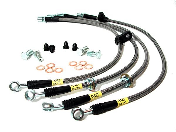

I have a 1975 Stingray. I upgraded to Stainless Steel Brake lines and since that upgrade I've had three calipers lock up one after the other.

how about some more info on those "new" stainless steel brake lines? do you mean the flexible hoses that connect to the calipers in the front and to the trailing arms in the rear or something else? if they are the flexible ones where did you buy them?
Many of the vendors here carry them. Wilcox, ZIP, Ecklers, MAM, Vansteel, VB&P.
Wilwood, Earls, Stoptech, Russell, and a myriad of others make them. Just be sure to look for the DOT sticker to ensure that they are legal for street use.
