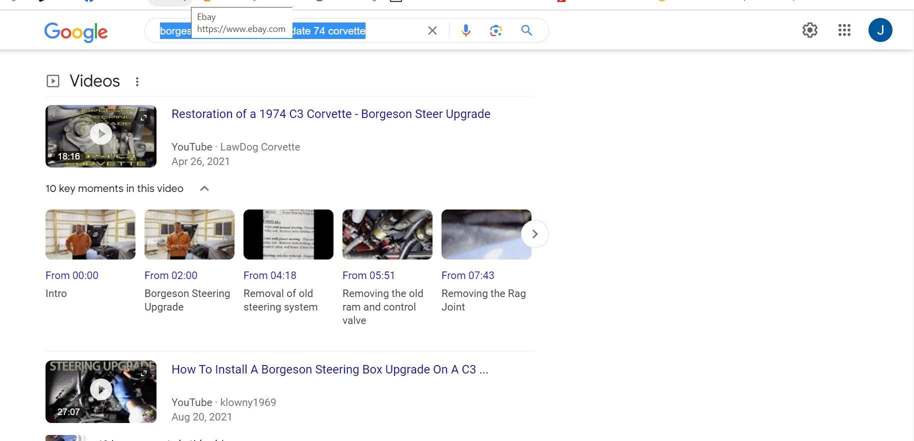

Old Jun 21, 2023 | 01:16 PM
max31's Avatar
max31
3rd Gear
Joined: Jun 2023
Posts: 3
Originally Posted by 65GGvert
I hope it works for you, but I hated the manual steering. I added PS (Borgeson) and it's a great pleasure to drive now.
Hey would you mind linking me to some instructions on this conversion? I am a new 74 owner with manual steering and looking to convert to borgesons ps system
Old Jun 21, 2023 | 02:52 PM
  #33
65GGvert's Avatar
65GGvert
Joined: Jul 2006
Posts: 22,192
Likes: 4,179
From: Kannapolis NC
type "Borgeson power steering update 74 Corvette" into Google. Lots of videos and instructions to choose from. Or just click this link:
https://www.google.com/search?q=borg...hrome&ie=UTF-8
Old Jun 21, 2023 | 03:07 PM
  #34
max31's Avatar
max31
3rd Gear
Joined: Jun 2023
Posts: 3
thanks for the quick reply I was searching that and all the videos seem great for installing the new power steering box but has nothing about how to install the power steering pump and pully on a car that doesn’t currently have it
Old Jun 21, 2023 | 05:25 PM
  #35
vettebuyer6369's Avatar
vettebuyer6369
Joined: Jul 2000
Posts: 53,988
Likes: 6,212
Please don’t post to an old thread about general questions or searching.
thus can be done in a new thread.
