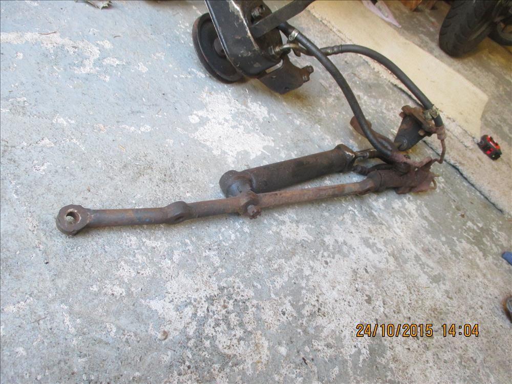

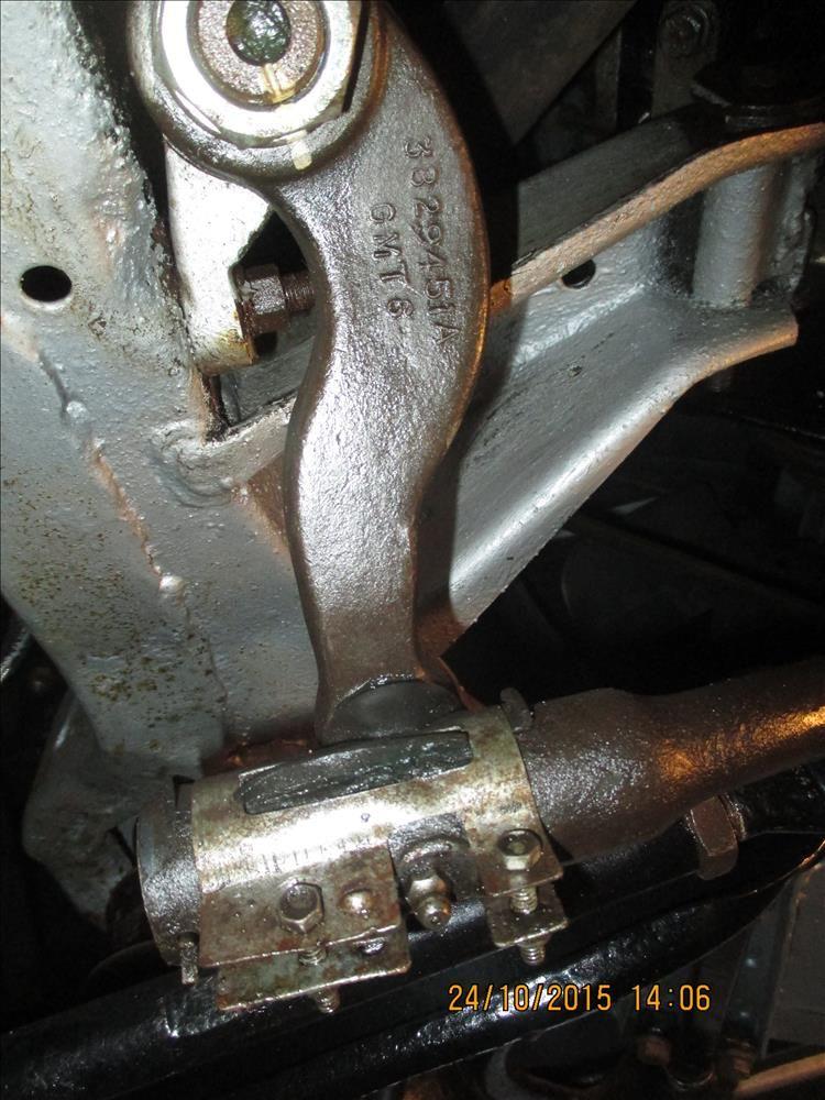

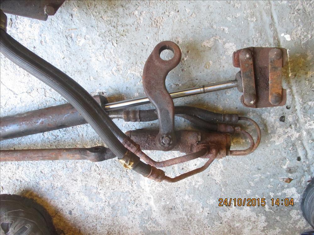

I dug out my old PS assembly to try and answer this.
It looks like the dimensions are all identical; from centre distances between the steering rods, distance from the pitman arm connection to the left steering rod (which is the same as the distance from the right SR to the idler arm connection).
Also the centre to centre length of the pitman arms is the same and the offset distance between the two ends is the same too.
So the differences between the relay rods are...
No hydraulic ram connector hole on the MS relay rod
A fixed pitman arm connector on the MS instead of a hydraulic valve
And on the pitman arms...
The "wobble" that the arm takes between the two ends looks different. The PS arm looks like a larger kick round whatever the arm is trying to clear. I suspect that it will be the mounting bracket for the hydraulic ram.
Here's some photos....
PS Pitman Arm "wobble"
PS Relay Rod with hydraulic ram connection
PS, PoS?
Manky old PS valve & hoses. Mr & Mrs Leaky
MS Connection knuckle and pitman arm
Entire MS relay rod with no ram connection point
MS Pitman arm looking straight up
If you've any questions while they're still out together, please ask...
