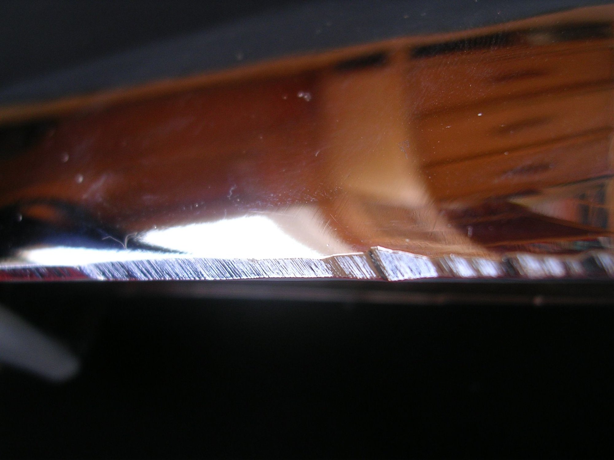

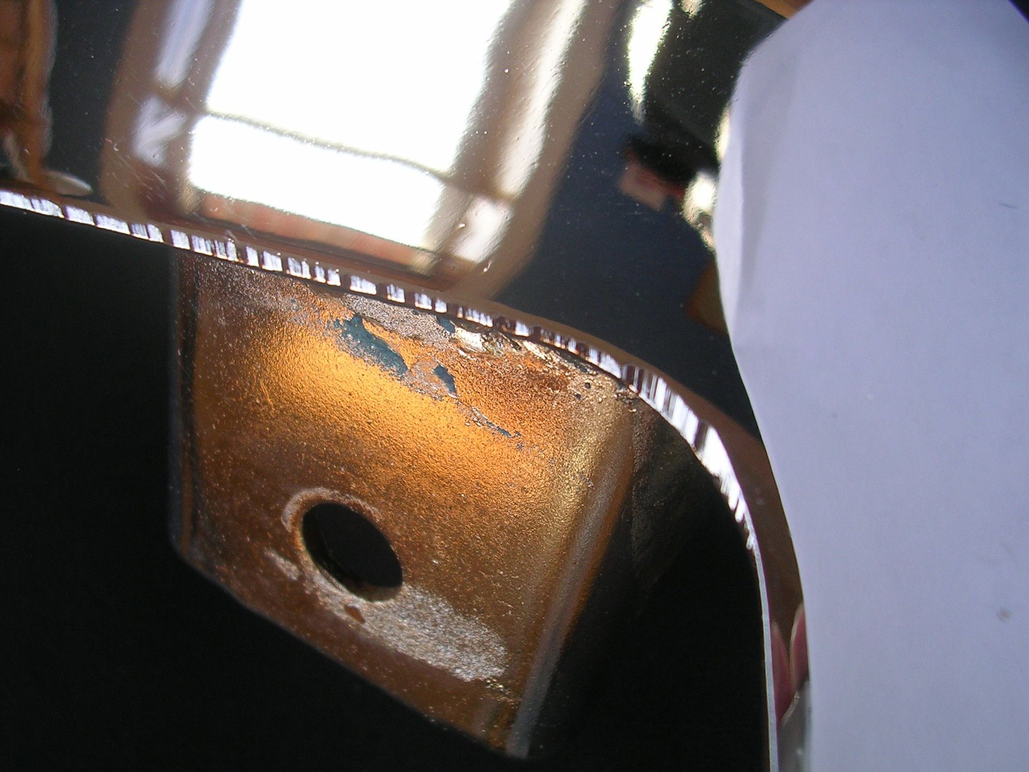

Thanks Alan and Graham for your replies about chroming. I took the rear bumpers to a re-chroming outfit but they have carelessly ground down the edges in the preparation process. I phoned a specialist in England called Derby Plating who say that the linishing belt machines if not handled properly are easily capable of causing irreparable damage to the parts. Have a look at the edge shown here.

Damaged edge
Damaged corner

Poorly done preparation of the base metal.

Hi Barry,
I certainly see that 'ground' edge and can understand why your disappointed.
I must add that the flat surface of the bumper doesn't seem to have been well prepared either.
What was the actual condition of the bumpers to begin with? When you talked to the platers about doing the work did they express any concern to you about what the finished product would be?

I would have though that edge would have been relatively easy to improve.
Added:, It also concerns me that it doesn't appear that any nickel or chrome were plated on top of the copper layor on the bracket that's visible.

That's shocking work and to cap it all the finish on the bumper is poor as Alan noticed as well, I've used Doug Taylor and Marque Restore in the past without any complaints, those damaged edges can be repaired by welding and then proper prep and re chrome, Doug did a bumper for my TR6 which was drilled for spotlights, holes were filled then the bumper chromed and you wouldn't know the holes were there.
