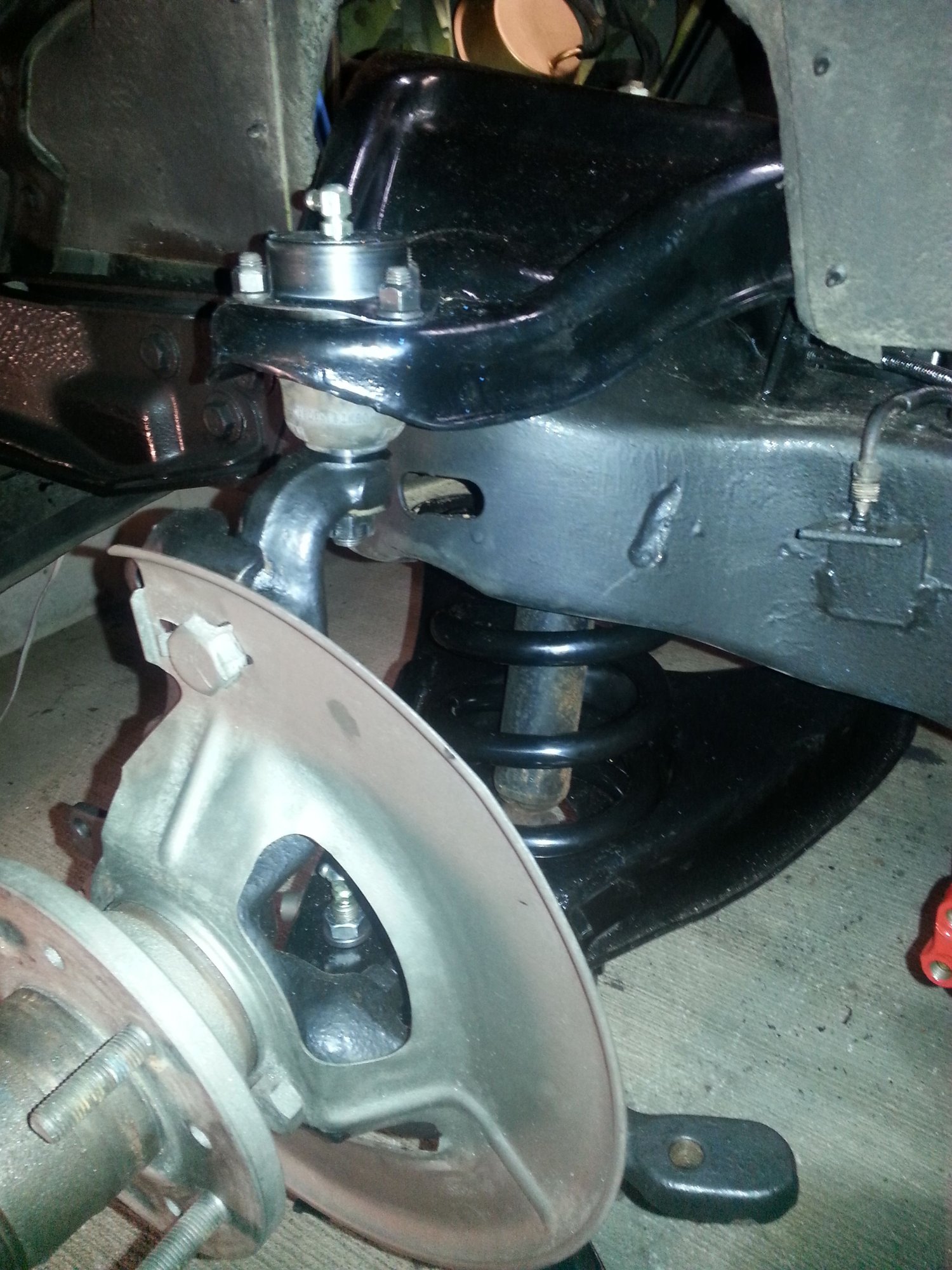

SUCCESS!!! I rented the coil spring compressor tool from Autozone. It took me about 15 minutes to install the springs. I made sure they are fully seated in the lower pocket. Also.. I used my original shocks just to make sure the coil springs were in correctly. Everything looks good. What I did was install the compressor tool from the top (its the one with 1 set of hooks), I grabbed the spring about 3 down from the top, I tightened it up and it pulled the spring up into the pocket. I made sure it was seated correctly up there and I then raised the lower control arm to where it was just touching the bottom of the spring. I then chained the spring to the cross member just for safety. I then took my foot and I pushed the lower part of the spring into the pocket while raising up the lower control arm with my jack. Piece of cake. It went in very easily. Connected my steering knuckle and SUCCESS!!! Check out the pics. Keep in mind.. the shock I used is my old original shock just to make sure I did it correctly.

Cool....make sure you drive it around the block to settle in before you tell us how it sits
