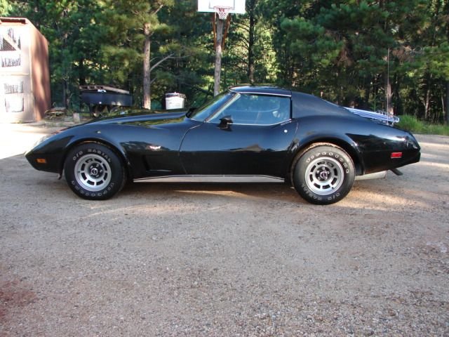

Originally Posted by REELAV8R
Love my side pipes with Dean's heat shields. Love the sound too. How loud it is, is up to you depending on the inserts used.
Before:
After:
What brand of pipes and heat shields are yours?
Hooker headers bought directly from Jet Hot with ceramic coating. At that time they only had the silver color. Looks like you can get many different colors now.
http://www.jet-hot.com/gallery/
Heat shields are Dean's heat shields.
http://www.steelshields.com/
I have the turbo spiral inserts.
http://www.spiralturbobaffles.com/corvette.html
I put all of this on the stock motor and had it that way for a couple years before I rebuilt the engine. It was a vast improvement over the stock exhaust system. Carb and timing tuning is needed to get the max benefit.
Side pipe tubes are just chromed 4" side pipes.
Get out you wallet if you go this route though. I see prices have gone up since I did it.
