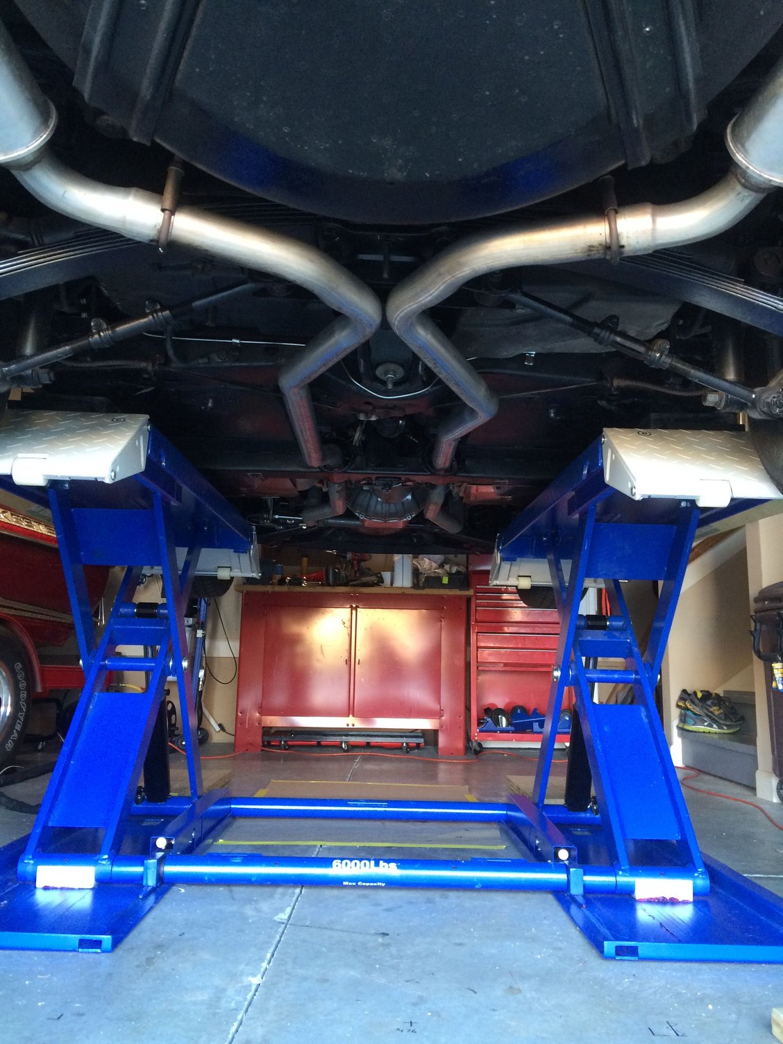

Again I don't have a dog in the fight on which lift any of you guys get. The subject of this thread is to highlight the different products on the market and how they fit within the hobbyist segment. The biggest difference between an auto shop getting a lift and a hobbyist is the hobbyist is generally not a professional, and does not have experience on which to back their decision. Additionally, since there is less exposure to danger than a professional (probability of an accident increases with use) they are more likely to make a decision that doesn't appear to be risky without having a good perspective to base that decision on.
For example:
________________________________________ _____________________________________
Now I just pulled this image and post off of google, but I would ascertain that this customer purchased the kwiklift because it fit into a budget and that was the main reason. (FYI there's quite a few of using wood ramps just like this out there) Like I stated at the start of this there is a lift for every budget, and the kwiklift very well may be the right lift for you. This thread is to help you come to your own conclusions based off of my experience in the industry, and to any further learning I can point you toward, rather than looking at cost as the primary purchasing decision.
I won't be talking about kwiklift anymore, as I think it is pulling this off topic.

Something looks wrong with the scissor lift photo in the original post. My MR6K-38 manual is very clear that the engine should be on the other side of the lift so that the center of gravity is over the lift pin where the hydraulic cylinder pushes.
I prefer the MR6K-38 design. It is heavy construction, has dual tie bars for the scissors, and has safety latches on both sides. The construction and design is very heavy. I am not as comfortable with the dual stage double height scissors.
As mentioned in other posts, the safety comes from design, install, and operation all being in order.
