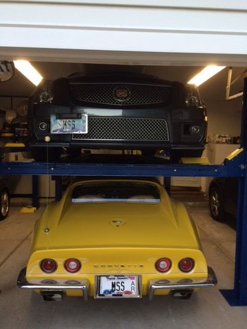

I liked the BendPak 4 post lift so much I bought two. What sold me was the safety lock system and that it can't be operated without the air compressor on.
