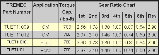

Heres the tag.

What is the the 6th gear ratio? 0.50? If so you are talking about a 1.4 effective rear end ratio in 6th with 28 inch tires. That's pretty tall, about 1200 rpm at 70 mph. If you have any kind of performance cam in your BBC, you'll most likely be lugging it too much causing bucking and surging at anything less than some pretty fast interstate speeds.

1386-000-007 1993 Camaro/Firebird w/3.23 final drive "M29" 400
1st 2.97
2nd 2.07
3rd 1.43
4th 1.00
5th 0.80
6th 0.62:1
Stock rear axle 3.28:1
Here is tremec's calculator
http://www.tremec.com/calculadora.php
I have a T56 Magnum with a 3.08. Which is ok for all gears 1st-6th.
It isn't a off the line launcher but I use the car for road track driving. 2nd-4th. Driving to the track is 5th & 6th driving. Close ratio starting @ 2.66 1st with a .63 6th.
Your setup would be 1525 RPM @ 70 MPH and 1575 with 27" stock tire size. Your setup is not the best if you like the 2 sec acceleration in first that most people seem to like.
The testing I did was looking at 2000 RPM - 5500 RPM in each gear to see if I liked it. for you this would be 20MPH - 54 MPH in first gear.
The ideal rear ratio as designed with the original factory design would be 3.28:1 and a 3.3 for the corvette would be great option to look at.
What tires do you have that measure 28" dia ?
