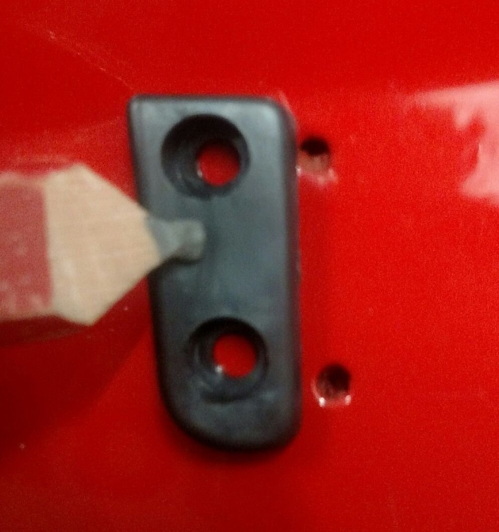

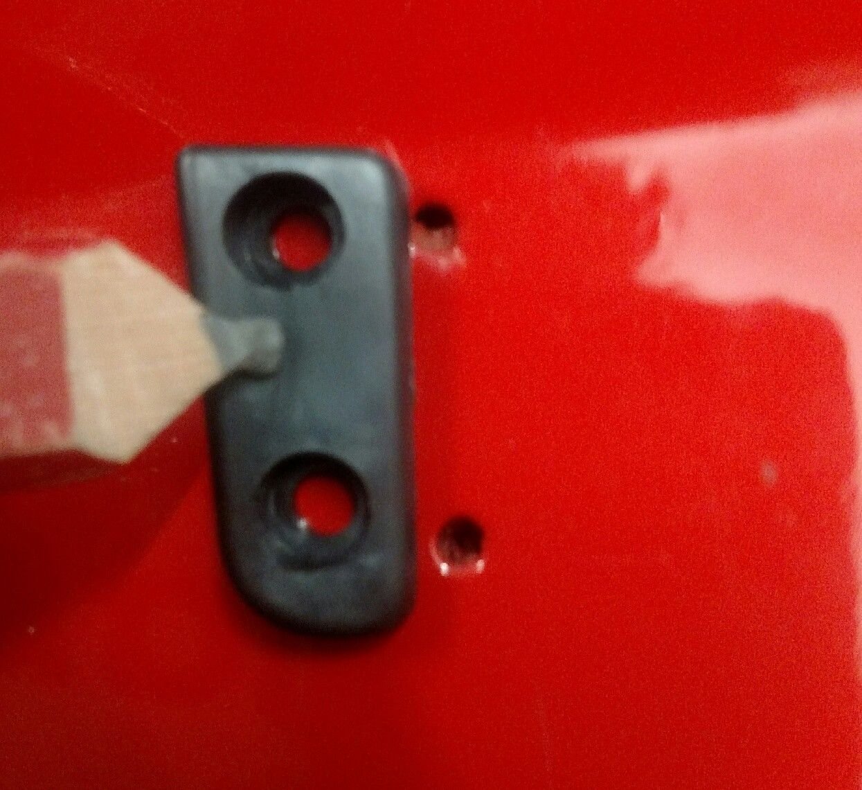

The door wedge sets sold by all suppliers I've found is the same. The plastic part will not fit '68 corvette as the mounting holes are too close together. Metal part and shims are ok for the door side. I think its a generic set intended for GM A-body cars like Chevelle, Monte Carlo, Lemans, Skylark etc. but NOT Corvette. Don't waste your time and money, it does not fit. I'm planning on fabricating a set of the plastic parts but if anybody knows of a supplier that sells the correct CORVETTE ONLY set please let us know.

Supposed to be this. How they managed to post the base64 encoded image as a wall of text is beyond me.
