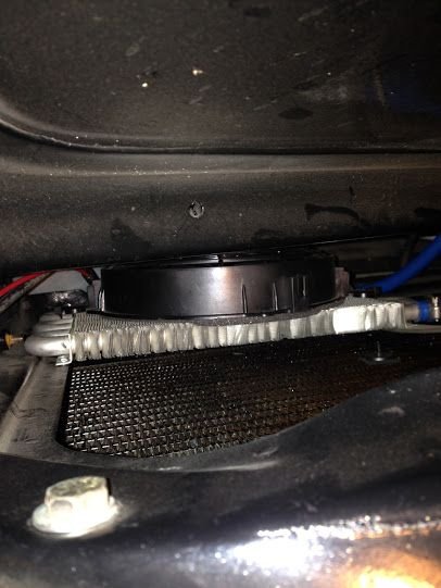

I have a Th2004R transmission running through a stand alone tube and fin cooler like you are looking at. I installed a gauge sensor in the pan and think of 150* as my red line.
I initially had it mounted directly on the radiator with a puller fan on the radiator. After an hour long drive and some hills it would start to heat up at a stop light if I did not get moving. It would climb past 150*.
I then mounted a small fan directly to the cooler. The fan was set to come on when the engine temp. goes over 180*. I thought this would help at stop lights but it was marginal.
Finally, I went with the setup you see below. There is a space between the radiator and the cooler and a pusher fan on the cooler. This is what I ended up with.
The electric fans only come on at stop lights and the temps are usually between 100 - 130 in the pan.

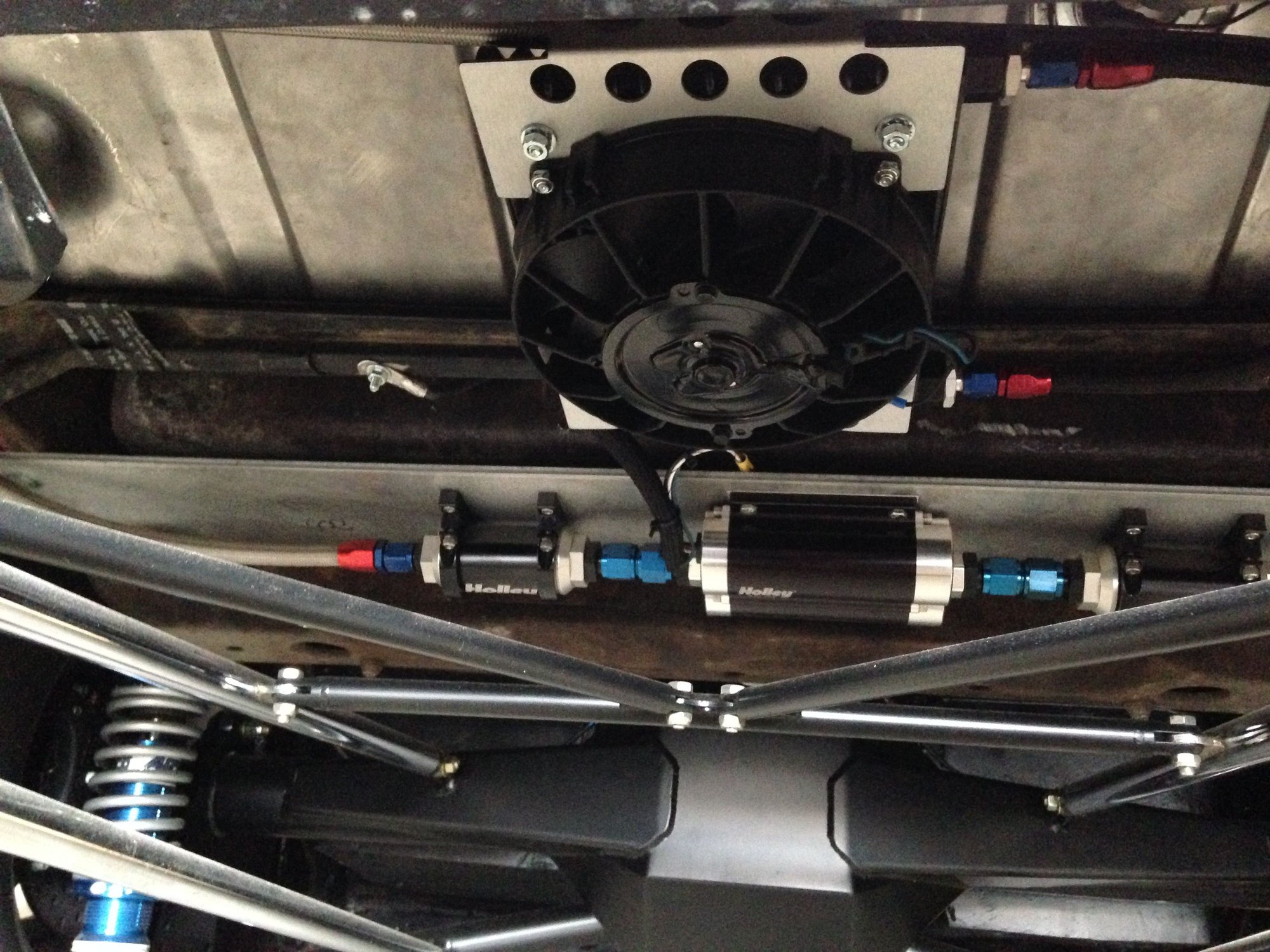

Here is my setup mounted under the tank where I do not have a spare tire. I live in South Florida where heating up anything is not needed only cooling.
Since there is no exhaust or engine heat back here it keeps the trans nice and cool.

So I decided to have the trans. cooler w/fan mounted in the back for more clearance and air. Now... since I received the wrong size SS hoses I had to run to PepBoys and buy the ProFlex SS braided hose they had in stock...is this a good choice for transmission lines?
