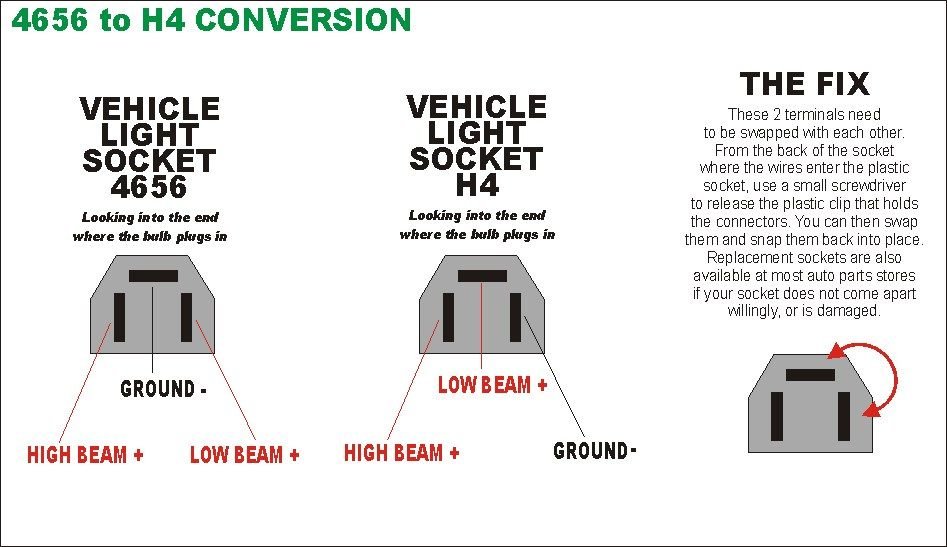

Did you modify your headlight connector wiring? H4 pin out is different than sealed beam.
http://webpages.charter.net/ceday/Camaro/4656%20to%20H4%20Conversion.jpg
http://webpages.charter.net/ceday/Ca...Conversion.jpg
This has to be done on both the lowbeam and highbeam sockets?

No....just the low beam connector. Don't bother using the Chinese "ceramic" connectors you see flooding EBay either-theyre about as stout as dried toothpaste. And, their 59-series terminals are pretty cheap as well-nothing beats using genuine Packard/Delphi connectors and terminals.
