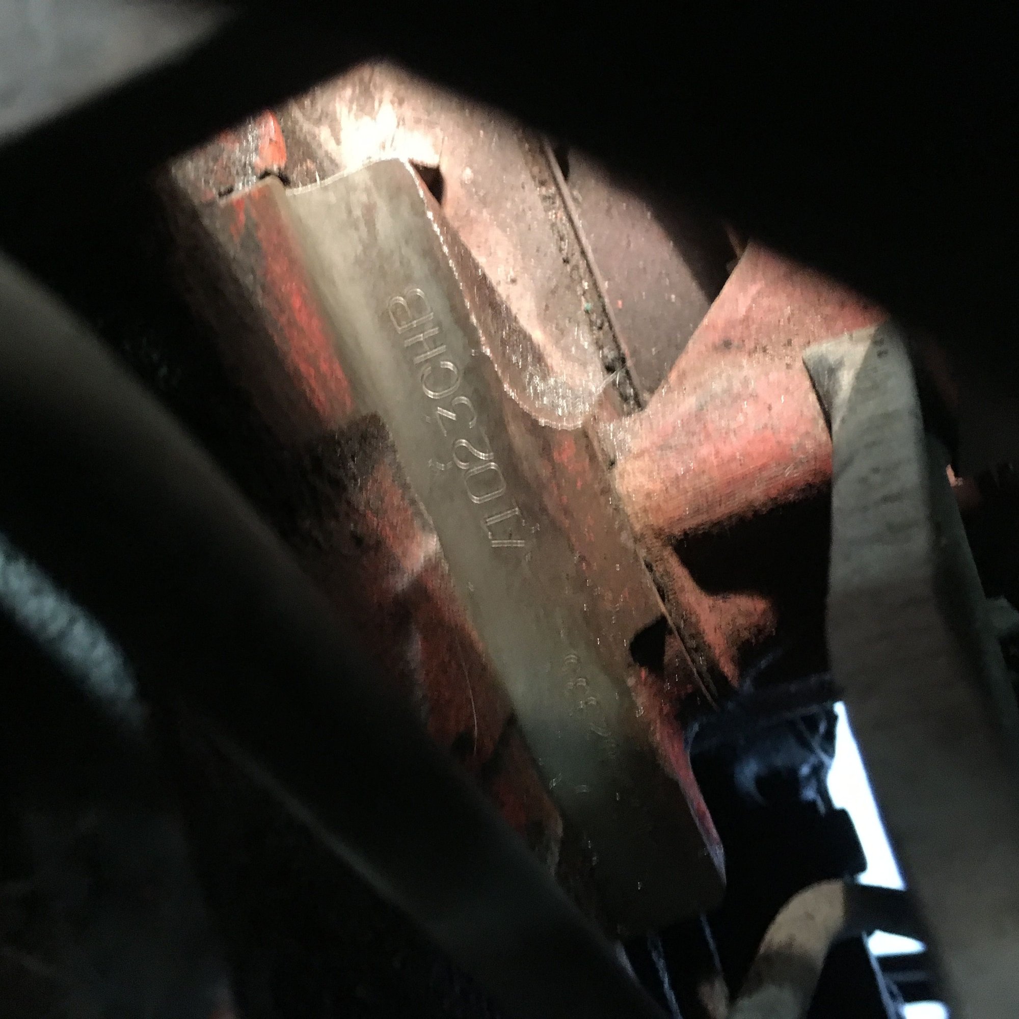

Is this a mistake or is my book wrong?It shows CHB but should be CRK according to a manual I have. The serial number on the lower part of pad matches the vin. 1975 ,350, Auto

CHB= 1975 L48 Automatic trans, fed emissions.

I believe is Jebby correct.
CHB 1975 350cu/in a/t, fed L48 165hp Corvette
