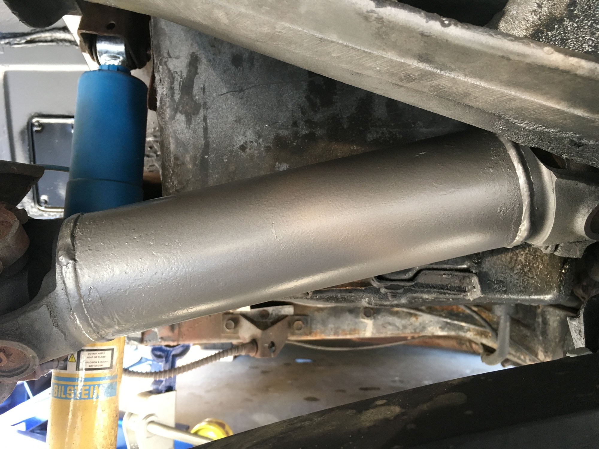

Just painted my half shafts with cast blast so here's what that will look like...

Alan, the new ones that I picked up from Fort Wayne I had them clear coat, I did not realize they would have a dark horizontal seam from end to end. Do those pictured here also have such a seam? I think I am headed to paint mine anyway, I like that silver....

The heat zone/weld seam has been lost on the drive-shaft in the photos.
The dark heat zone along the length of the tube is the result of the manufacturing process in which a flat steel sheet is rolled and welded into the tube shape.
Many folks would be delighted to be able to duplicate it when restoring half-shafts and drive shafts.

I think the shafts in your photo are pretty NICE looking!

those shafts with a coat of clear would look good.
