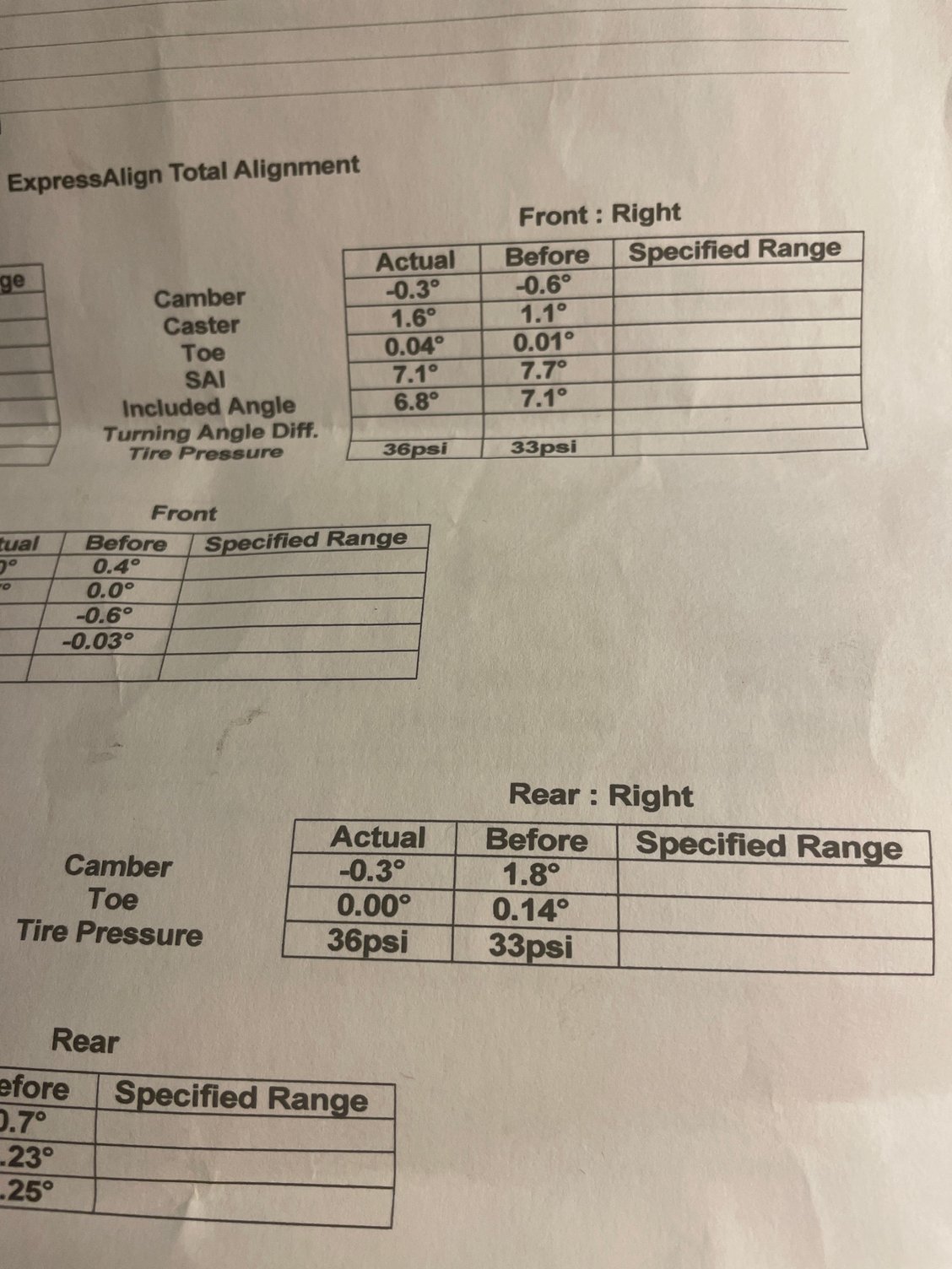

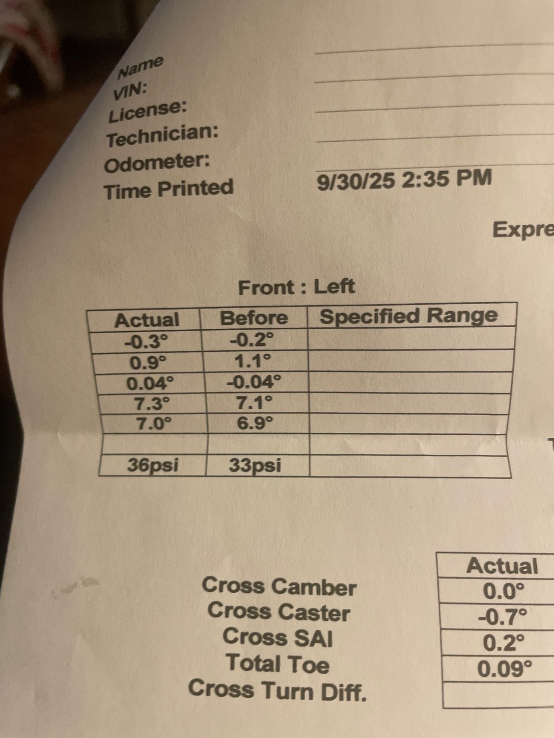

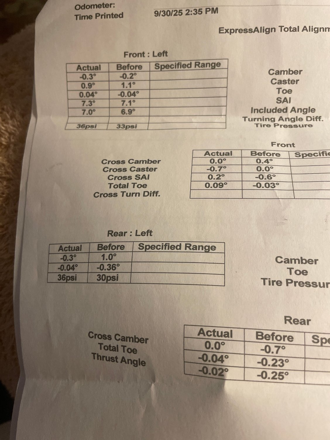

Here is my wheel alignment specs

The post is from 2016.
