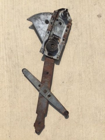

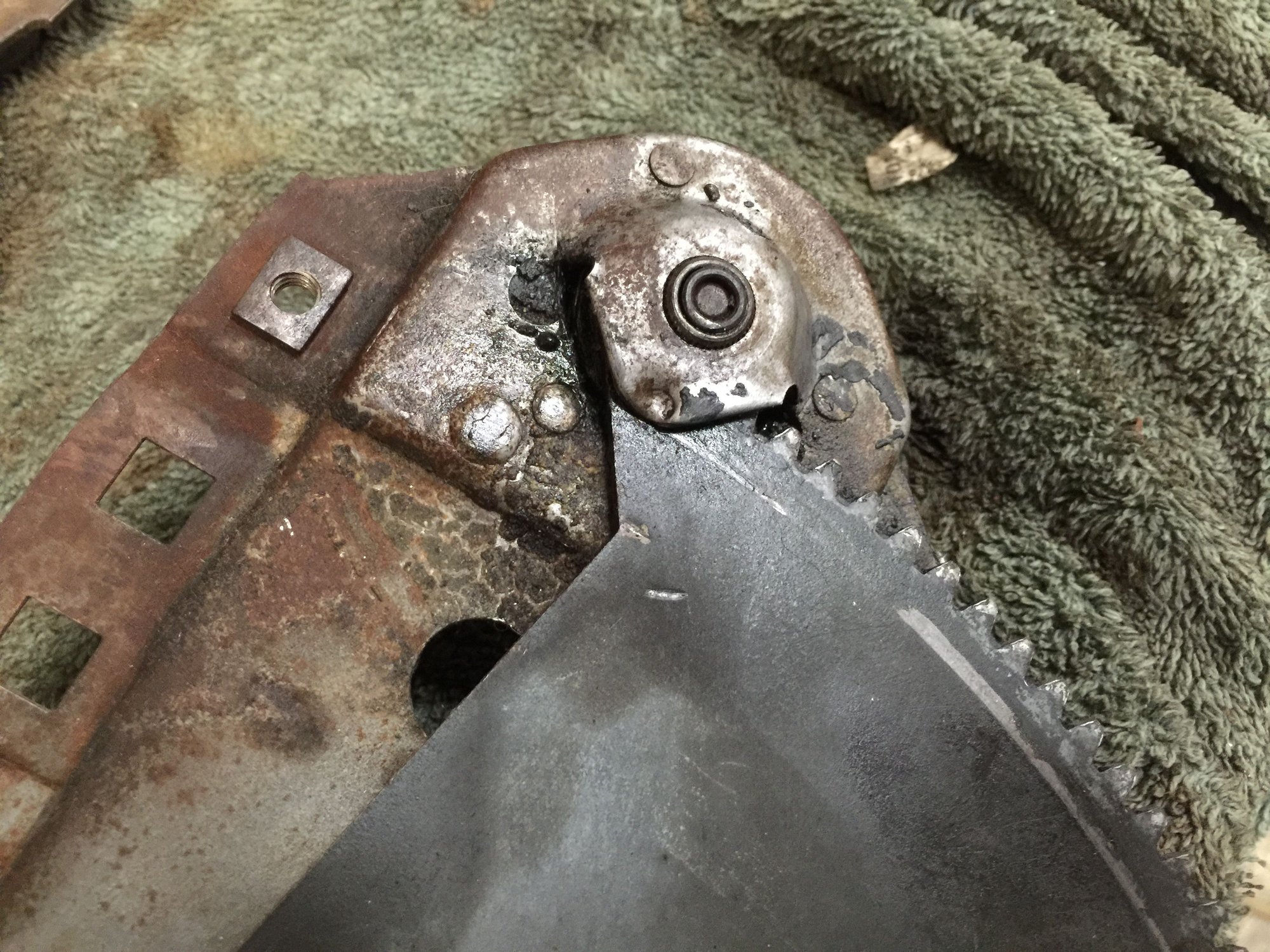

After cleaning up passenger side window regulator (it was nasty), it functions fine now except the brake will not hold the up/down position when you release the crank (see pix below). So first question:
Is the brake fixable? if so, how?

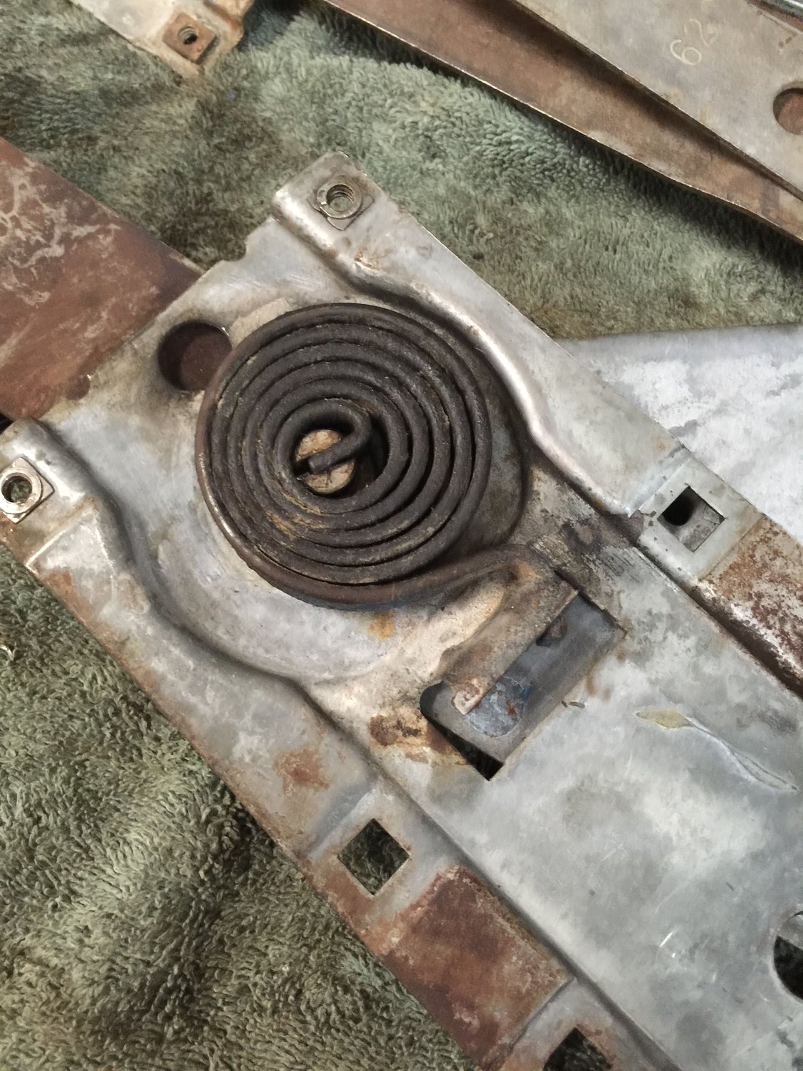

If not, I have an extra driver side regulator and it APPEARS to be identical to the passenger side except for the direction the spiral spring is tensioned. So next question: Are they actually the same besides the spring issue? And if so, what's the easiest way to get that spring off and reversed?

This is the brake
And here's the spiral spring

Yes, mine is Vette regulator - but it is manual windows (see below); yours appears to be power windows.
This is the passenger side regulator with the brake problem

OK, now I understand you have a non-power regulator.
The big gear looks good, is there a way to examine the small gear?

I guess I could drill out the rivets . . . but there's the quandary because I know the gear itself is good as I can hand crank the whole distance of the big gear (and it tracks fine). The problem is that when I let go of the crank, the spiral spring takes over and moves the crank, the gear (and the window) back to ground zero. As mentioned, the driver side is fine. When you crank it, the gears turn and when you let the crank go, the gear and window stay put.

Could the spring be on backwards? It's supposed to help raise the window.

Although anything IS possible with this car (bought it in boxes), other than being a little clunky/sticky prior to my dismantling it - it worked fine. Therefore I don't think it is a spring direction issue. As expected however, the driver side is OPPOSITE direction. By the way, I never took the regulator itself apart - just cleaned it up. But that gunk must've been what was holding it together!
OK, so if the spring were on backwards, what is the easiest way to remove it. How do you get the tension off of it in order to remove it?

OK, so I just confirmed thru some online photos that my spring IS on in the correct direction for the passenger side. So the problem gets back to being the brake failure. However, I did find a good, used regulator on ebay and went ahead and bought it. When I get a good working part in hand, I'll feel more comfortable about possibly drilling out the rivets and looking inside the brake unit to see exactly what's wrong :-)

It does look like your spring is facing the right way
http://www.ebay.com/itm/1968-1982-C3...tVaNQU&vxp=mtr
Could is just be weak?
I think if you put the regulator in a vise you can unwind the arm and take the tension off, but as you have figured out I have no experence with non power regulators.

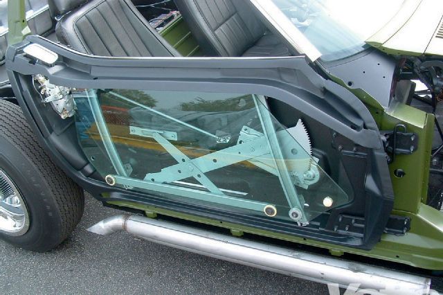

Wayne, here's a picture of a passenger side window regulator (manual) installed in the door...
Is this what your looks like when installed? The coil spring should be fully coiled at this point, window down. I'm not aware of a brake on the window regulator. The spring is what assists in lifting the window into position. It is a balance of the weight of the window being countered by the tension in the spring.
