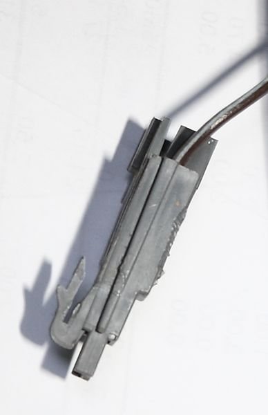

Old Mar 4, 2016 | 06:45 PM
454Luvr's Avatar
454Luvr
Posts: 823
Likes: 57
From: Austin TX
OK, I Pulled the plug and removed the fuse. Here's a pic of the plug (it installs with the tang facing up). Below it is the 35-year-old homemade tool I used to remove it. The tool also works great on big speaker grilles.
To '82 Fuse Panel Help
