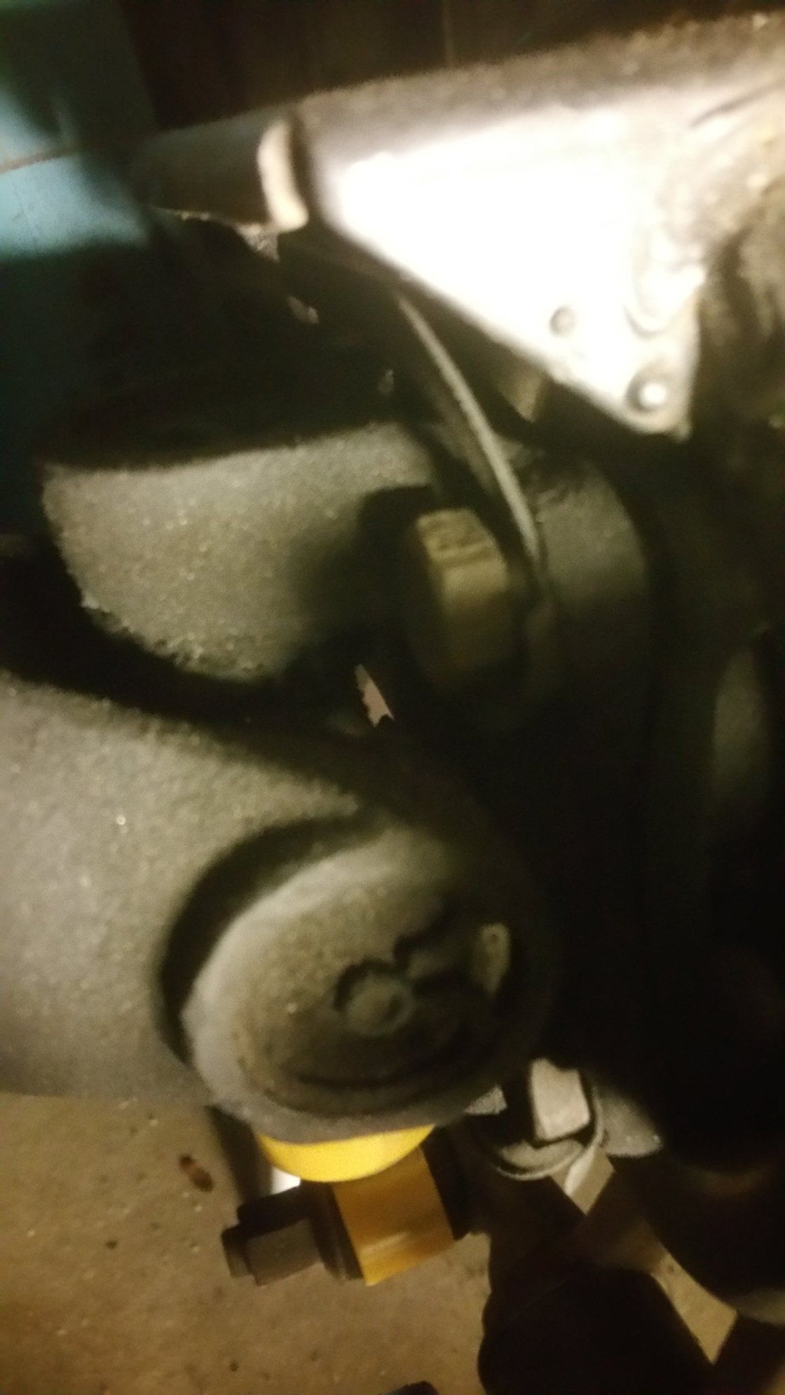

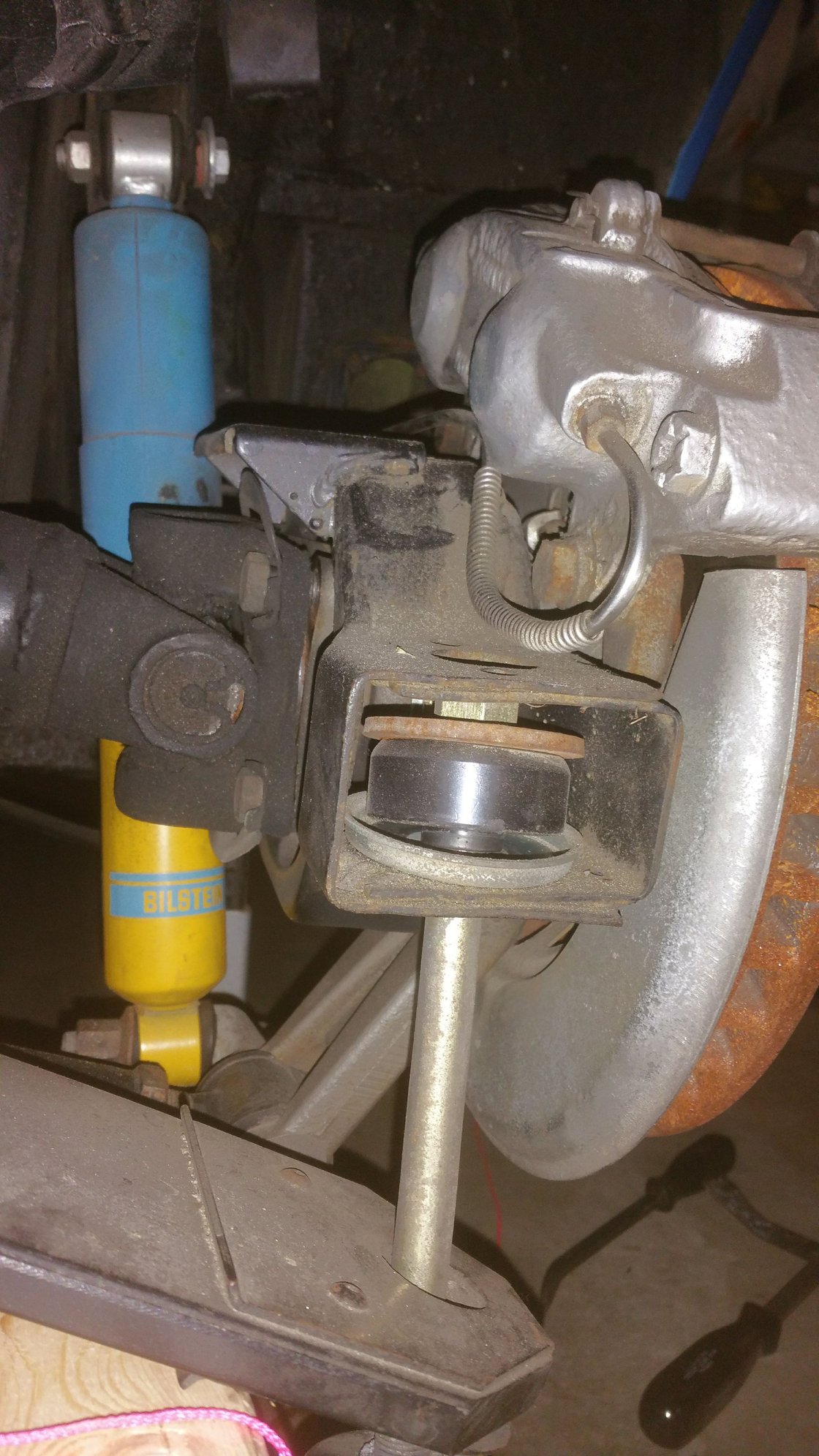

My Bubba did me a favor and didnt bend the french tabs up. So they loosened themselves. Luckily they didnt fall out.
Good catch that could have been a night mare if they dropped on the highway.
