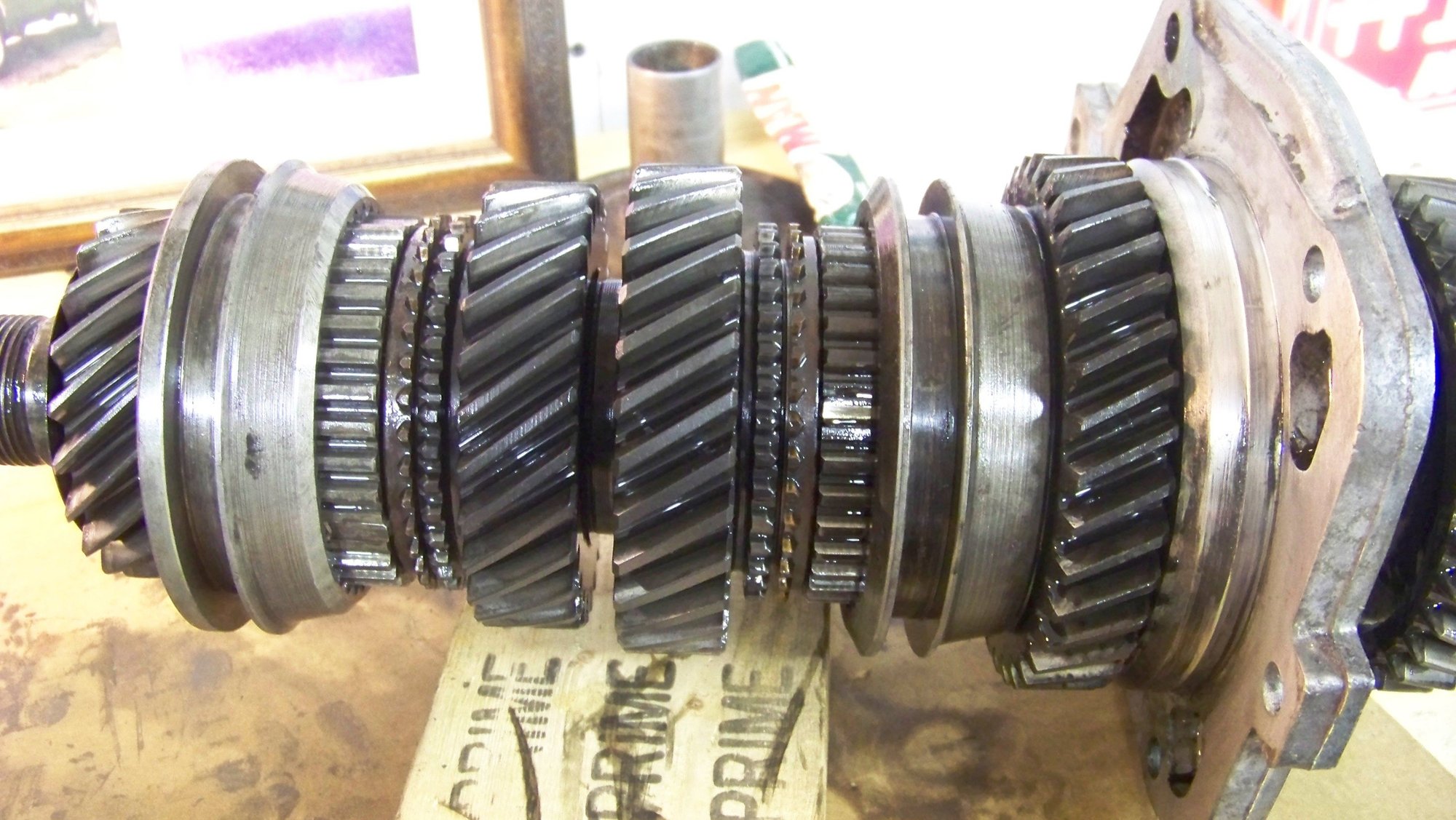

oz here is a pic of my 72 muncie m20 looks like your gears i think the m22 gears were not beveled as much had more of a straight cut hope this helps

He has an M22. Other gearboxes have a gear angle of ca. 45°.
However the straight angle of the M22 is more prevalent on the lower gears.

Carl, if you refer to post #1 you will have a clearer view of the gears. As Belgian saying the pitch is more noticeable on the lower gears.
