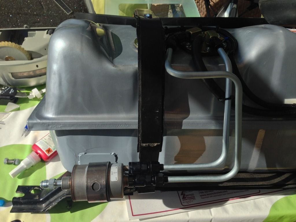

Hi, I use the Tanks inc complete fuel tank kit . I don't know what year your car is but they drop in up to 1974. I did replace my fuel lines during the frame off, but it supplies my Terminator efi without problems. On the end near the tank and in the engine compartment I used Swagelok couplings to 6 AN. Cut of the bubble on the hardline, slide the coupling on and turn it tight, done. From the C5 filter/regulator I have a small piece of tefon lined FI hose to the hardline. In the engine compartment the same, from the hardline to the fuel inlet of the TBI.
The filter can be reached when you take the muffler off.
Nick

dembo have you installed your tank yet is so i'd love to see some pics of your tank installed

Yeah the install is complete, I'll try to take some pictures this weekend
