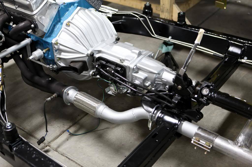

I switched to a true dual exhaust on my '80 when I put in full length headers when I had the original Super T-10 transmission. I modified the front cross member on the drivers side as I explained briefly with a few pictures here:
Modified cross member for true dual exhaust
Let me know if you'd like more pictures and explanation of this modification.
I later upgraded to a 5-speed transmission kit that came with a new front cross member already made for true dual exhaust. I sold my original dual exhaust and cross member to a guy at work with an '81.
The OP doesn't need to modify the cross member on his 79, to add dual exhaust.
Unlike 80-82's, that only have a dimple in the right side of the cross member, 68-79 cross members with two holes in them for the exhaust pipes to go through.
All that's needed to convert a 75-79 to dual exhaust, is a stock 74 exhaust system.
