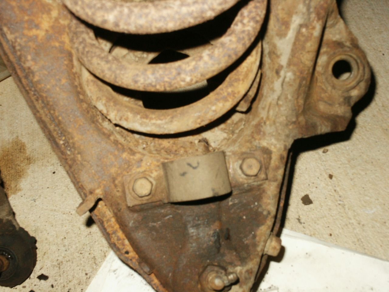

Did you check to make sure your shock wasn't loose on that side?
Did you seat the spring in the groove at the top of the spring tower and bottom of the a-arm?
That is all I can think of.
This is on my 73 before I removed the spring on the a-arm. You can
see the groove that the end of the spring has to be in.
Donnie
