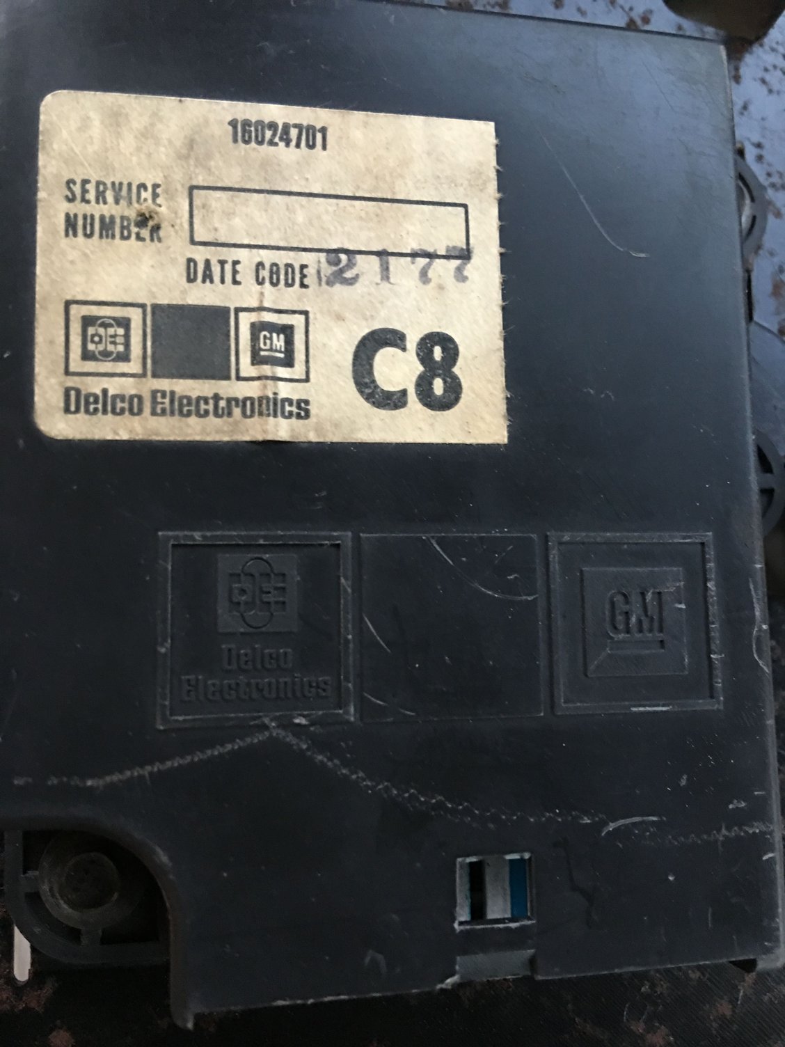

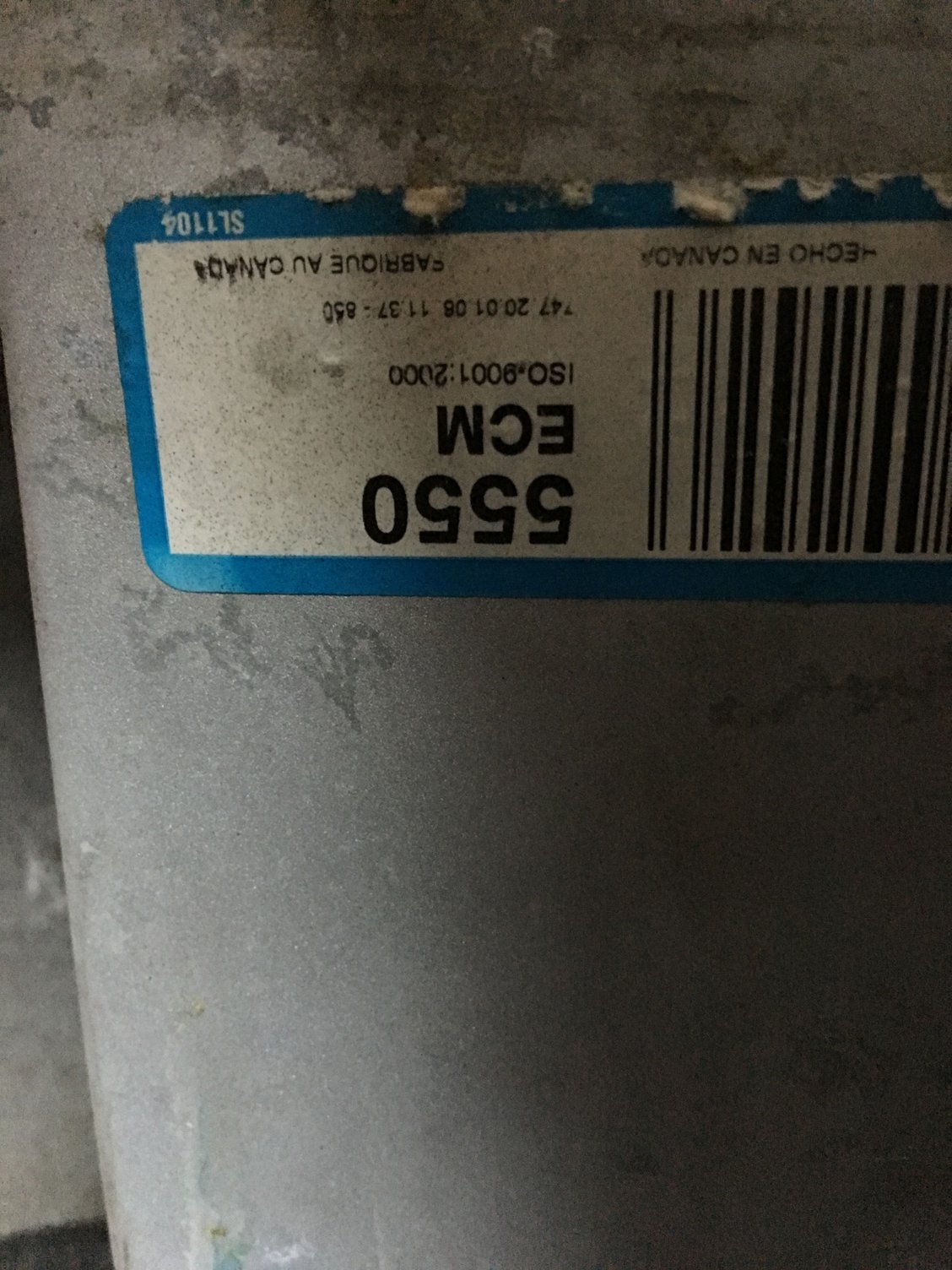

I pulled ecm goin to order new one but is this right one and i beilve it has a chip also can someone tell me what black box is
The black box behind the ECM is the Electronic Spark Controller (ESC). I found a new old stock item on eBay for $80 and replaced it, along with the fuel pump relay that you see mounted to the back wall. The ESC can cause the same stall-out issue so I just went for it while the patient was on the table.
Regarding your ECM, they are still widely available and with up-to-date electronics. They will want your old one back for core credit. Regarding the chip, your prior owner has already been in there. You have a HyperTech chip and not the OEM chip. I replaced mine with the HyperTech "Street Runner". Just make sure that you install the new chip with the notch in the chip facing toward the driver's side fender. It will toast your ECM and chip if you install it with the notch in the chip facing toward the passenger side while looking down from above as installed. (BTW, I used quality Velcro to remount my ECM and ESC to the black mounting plate instead of all those screws, which worked well).
There is no guarantee that these (3) items will correct your condition as it did mine. Because it would seem you should be getting applicable codes unless your existing HyperTech chip is throwing off the ECM.
See above response

Thanks im having a hard time to find the esc

Lakeside49's Avatar

Old May 8, 2016 | 11:38 AM
  #40
Lakeside49's Avatar
Lakeside49
Posts: 1,206
Likes: 365
From: The Motor City
Try eBay - I bought mine from this same seller and he did a good job, good quality NOS item:
http://www.ebay.com/itm/1982-1982-C3...HL6SOA&vxp=mtr
By the way, you probably realize that your ECM is also non-original based on the non-original "ECM" label. So, something is going on there - they usually don't fail.
