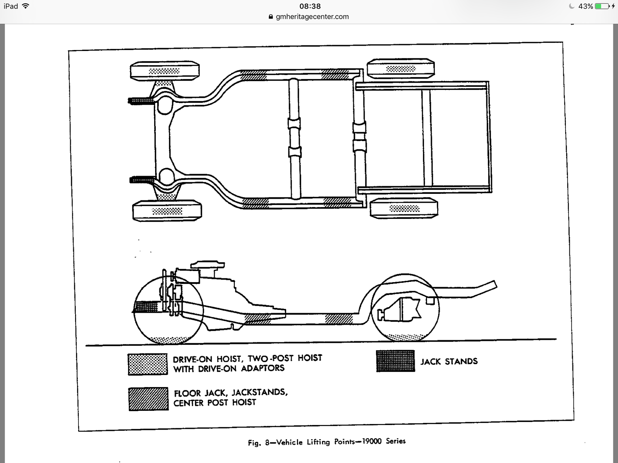

I used a ball joint separator like this. Was less than $20.
and as far as jack stand/ lifting points..
Thanks All,
I used the pickle fork and it came off without too much grief!
