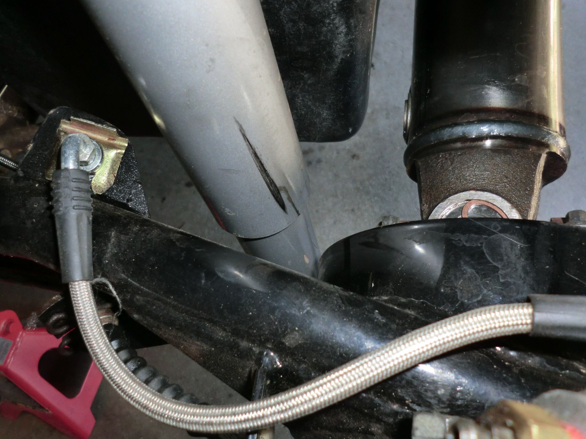

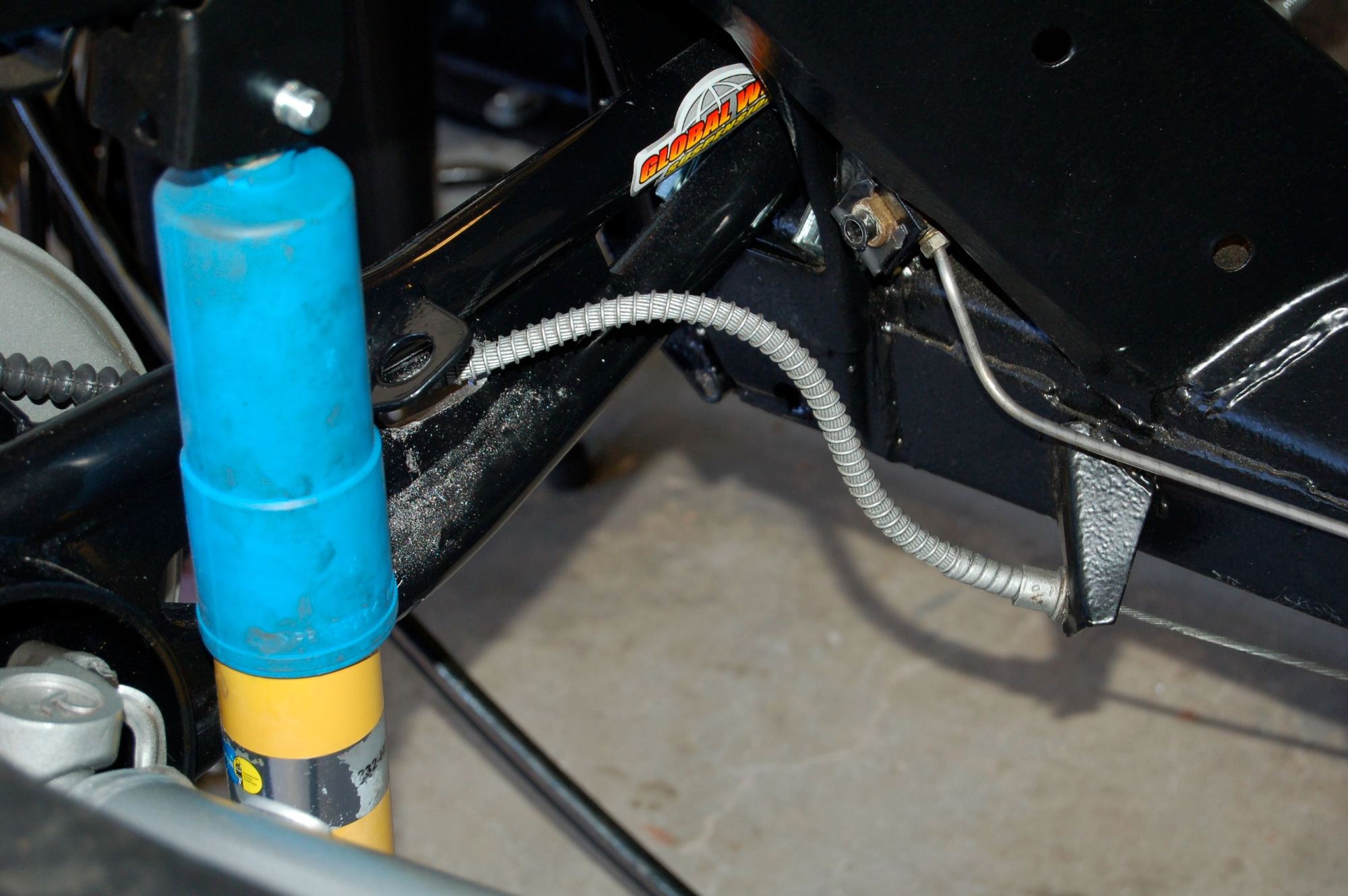

The emergency cable was a big problem, I had to hog out the through hole GW first provided. The debris you see in the picture is a couple of hours with a grinder. Complaining about this was my first post on this forum and I remember KidVette commiserating. Ah, the memories!
GW offered to exchange my arms to their credit when I complained but they were already installed when I discovered the problem. The brake cable does go through some contortions as well and I had to shorten it to get the emergency brake to work. I don't know what the fix is and haven't seen a picture. As you can see, the flange on the cable really doesn't sit all that flush on the body mount.

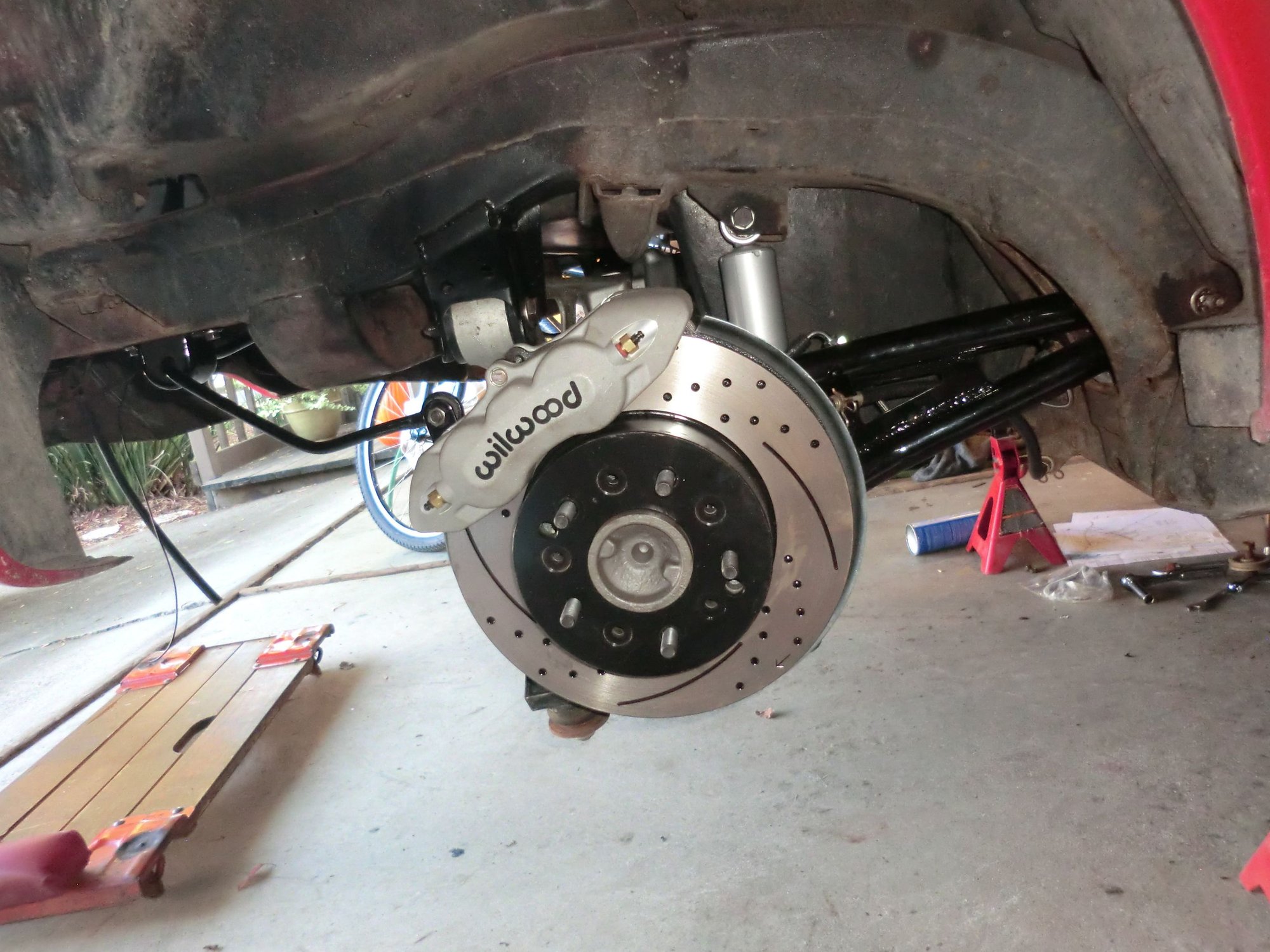

Like Kid Vette, I have Willwoods and discovered some issues with positioning the calipers and bleeding them. Basically I couldn't get a torque wrench on the mounting bolts until I changed to a 12-point smaller head bolt, so it was easily resolved. I can't remember if it was the brakes or the arms that gave me the problem but probably the former so you will likely be OK with stock calipers. I also vaguely remember a clearance issue with my shocks that was resolved with a couple of spacers. No show stoppers, but you'll want to look over your installation carefully.

Thanks for the link to that thread ignatz, I too wrestled with the brake cable and had the same thoughts about why such good looking / well designed parts needed modification. I'll post a picture of how mine is routed but its very similar to yours now.

As was said, we are all Beta testers with these after market redesigns. I will add one more thing to watch for, there were some hiccups with fitment when I installed Wilwood.

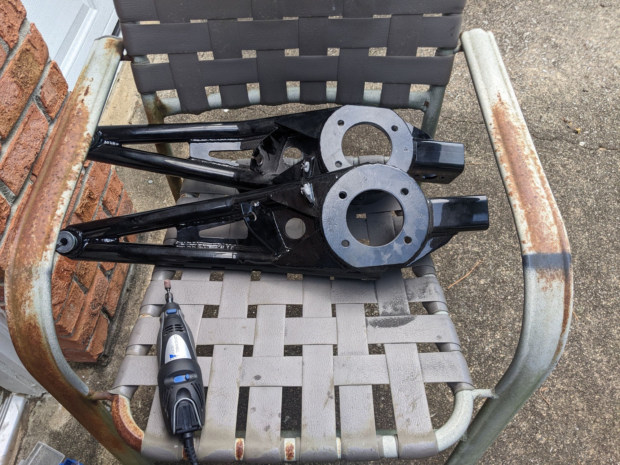

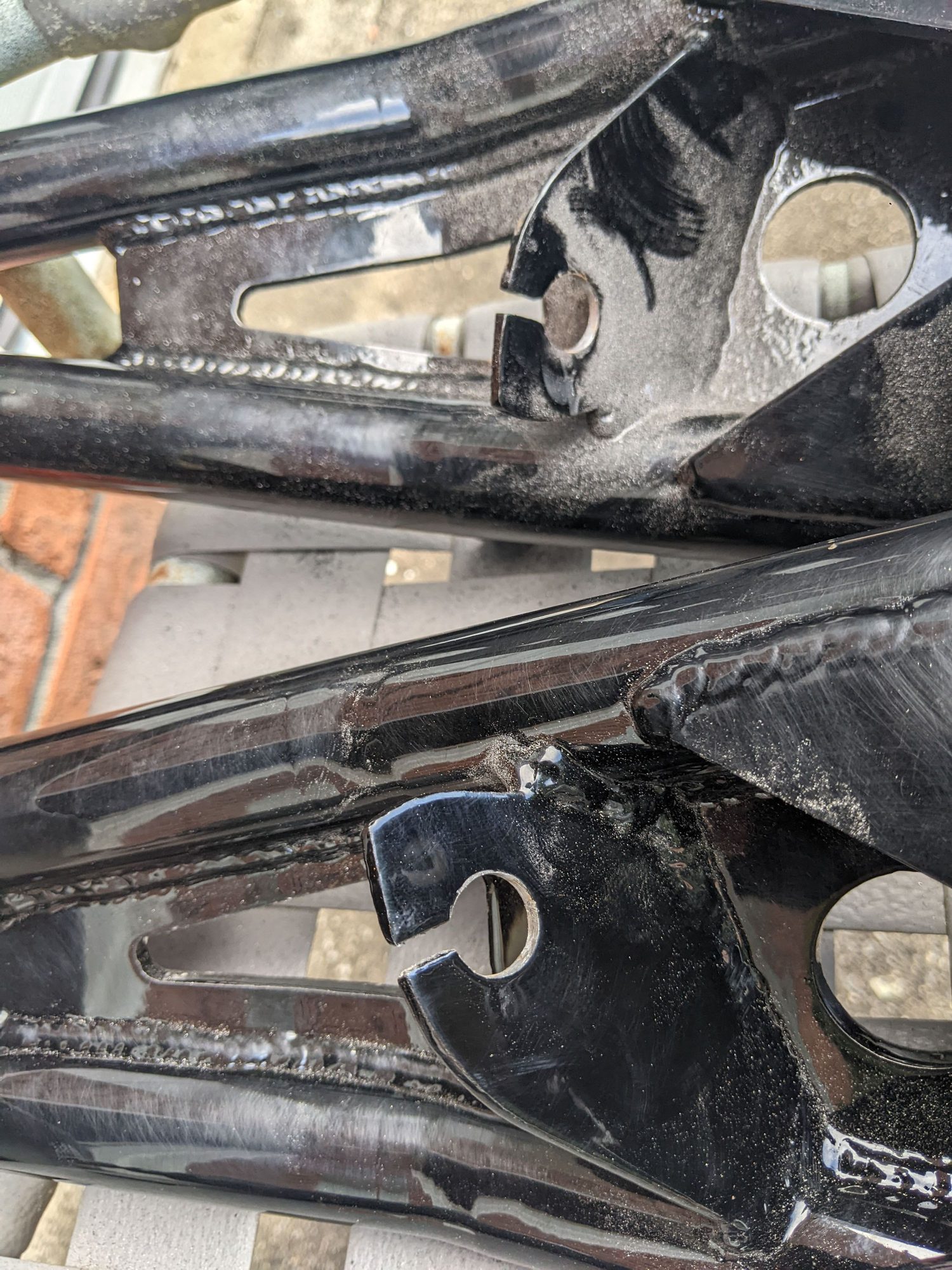

I recently began the process of installing my GW offset arms with rebuild bearing assemblies from ZIP Corvette. Similar to other experiences, I had to do the following things:
1. I had to use my dremel tool to remove the paint on the inside of the 4 bolt holes AND the inside of the large hole for the wheel assembly.
1.1. In addition, I had to spend a few minutes with the dremel tool opening up the large hole of the driver's side trailing arm a tiny bit (less than 1mm) because it would not seat against the bearing support.
2. I had to use the dremel tool to open up the bracket for the parking brake. This involved removing the paint, and some of the metal.
As far as I can tell, I do not need to clearance the gussets in the trailing arm itself to make space for the parking brake cable, but I will have to see when I actually install them. I will also give feedback on the parking brake cable length when I install them as well.
