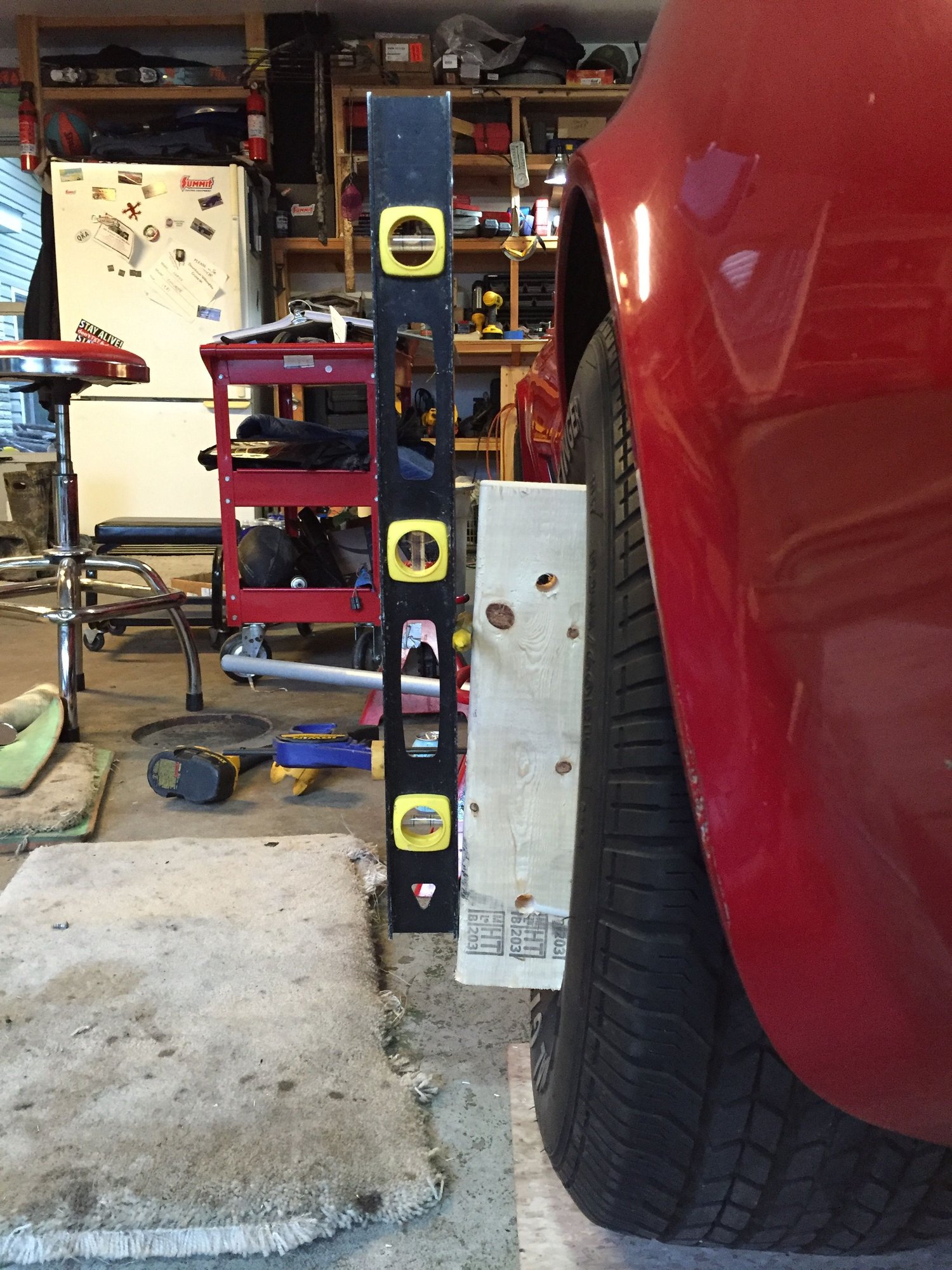

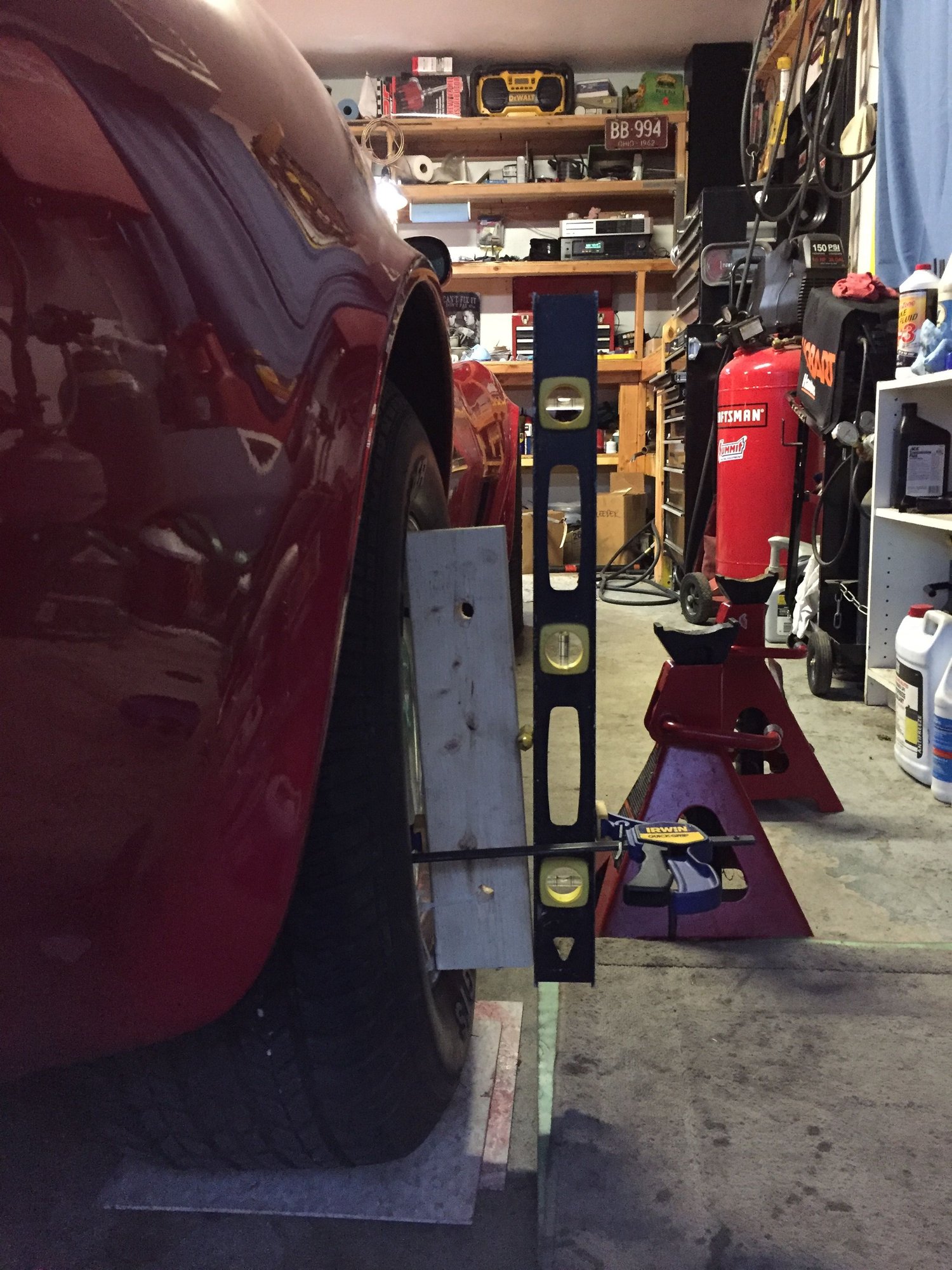

Sort of in the 'duh' category, but I figured I'd post it anyways. I had a bad driveline vibration and it had me stumped until I realized it was the camber which was way off. Fixed the camber and it went away. Camber was off after I did the rear end rebuild.
This is because the u-joints being not aligned.
Jim

Are the above pics showing before bad camber?
Old Apr 27, 2016 | 11:49 AM
jim-81's Avatar
jim-81
Joined: Dec 2011
Posts: 1,743
Likes: 289
From: Chardon Ohio
Yes!
