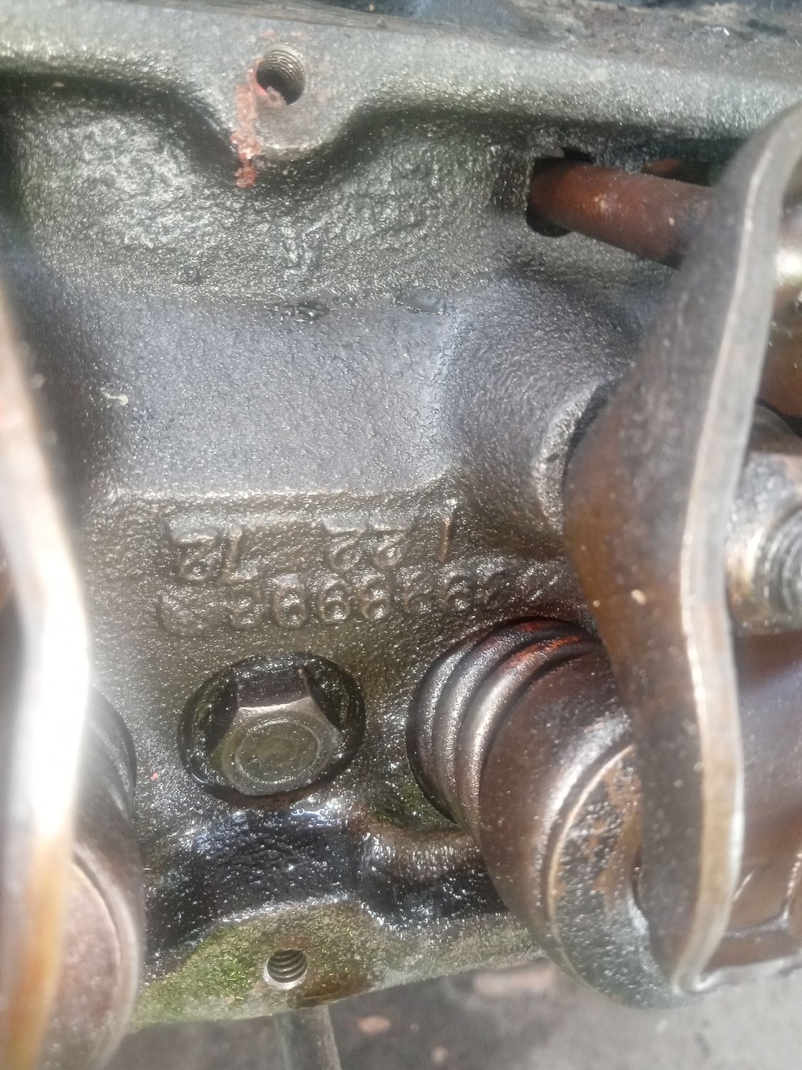

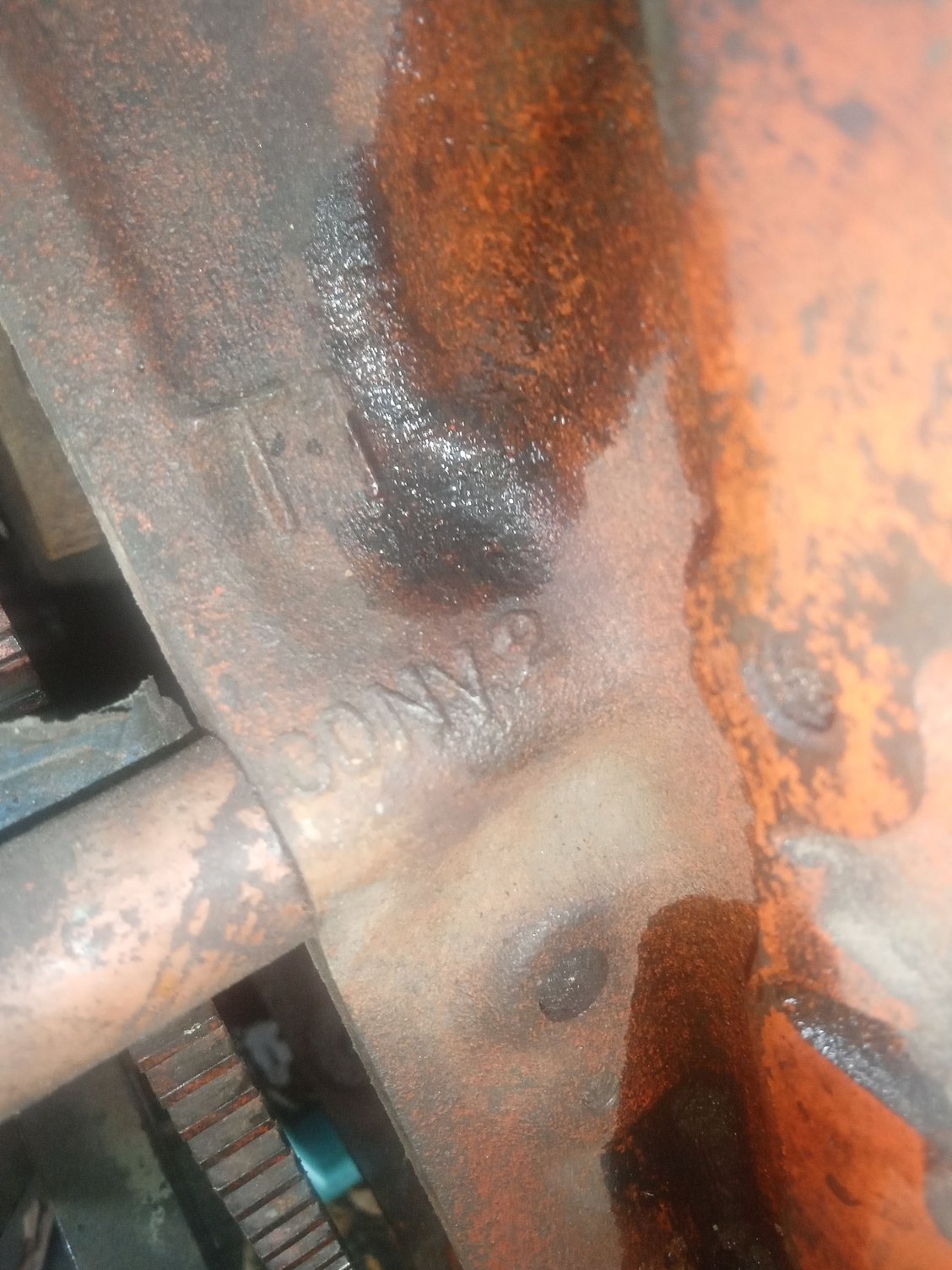

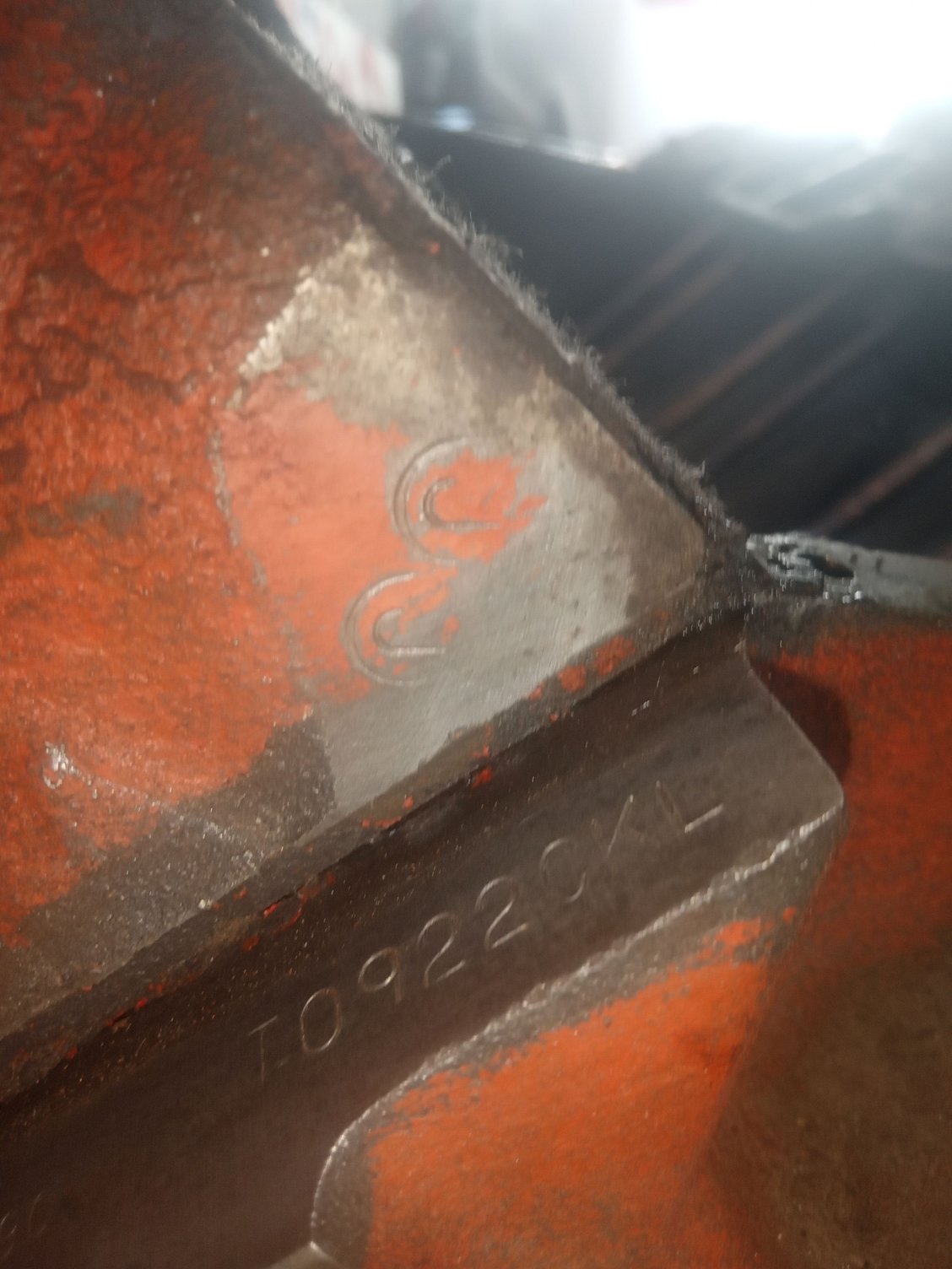

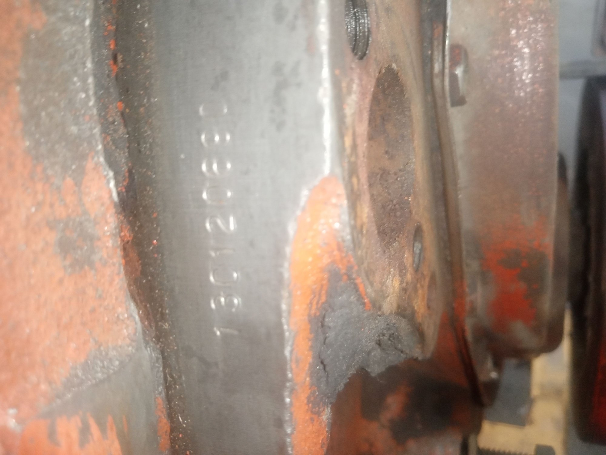

Default Chevy 350 smb need help
I recently picked up a motor year 1972 stamped block #3970014 the #s on the pad T0922CKL and 13C120690 crank #3932442 I don't have any clue what this came out of I bought for the right price i have a melling 22200 cam and lifters 7qt oil pan hi rise single plane manifold and 650cfm carb thats going to be put on it i have no idea how much HP it will make i do intend to put it on a Dyno please anyone that can give me an idea on the block would be extremely appreciated i

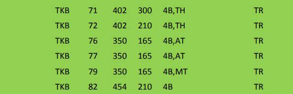

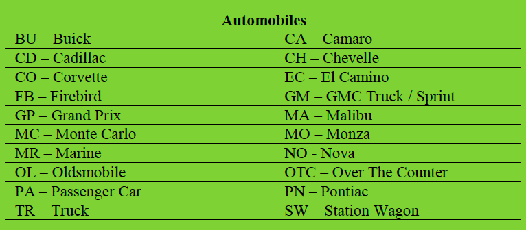

FJC
according to my lime book TKB was used for the following engines in trucks

Probably would have been better to put your Q and pics in a new thread.
You can find the Lime Book PDF in the C2 forum stickies.
The CKL stamp fits a number of different models, but not Corvette. One of the biggest clues for it not being a Corvette engine is that the Tonawanda foundry (indicated by the T in the engine stamp and castings) did not make any small blocks for Corvette, just big blocks. Being that it has a 1972 casting date, it's likely the 350ci/145hp.

Madman–
PS: The C in the VIN sequence (13C120690) indicates the Southgate, California, assembly plant used for passenger cars. (Corvettes used the S code for St. Louis.)
