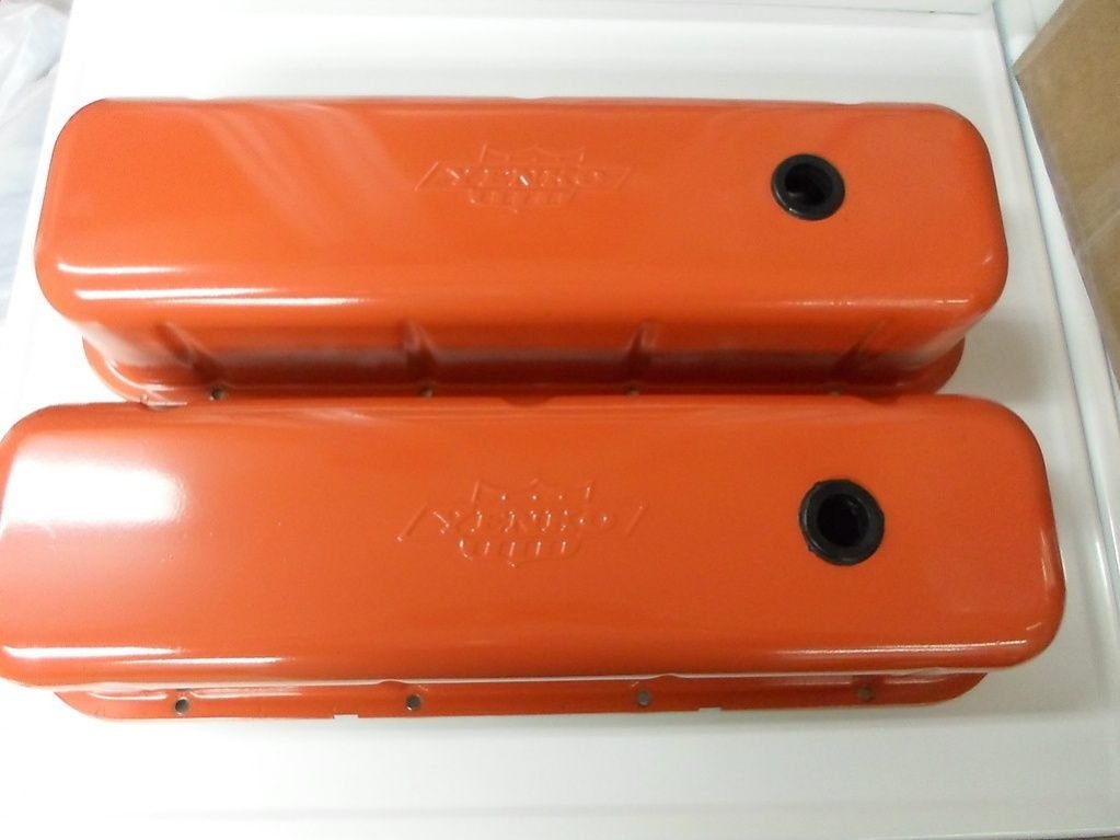

Thanks for your advice I may still get the CV item as backup to the one in top that I used, as for the valve covers brought these Carlisle 1998 when I visited USA first time to the solid axle club.
