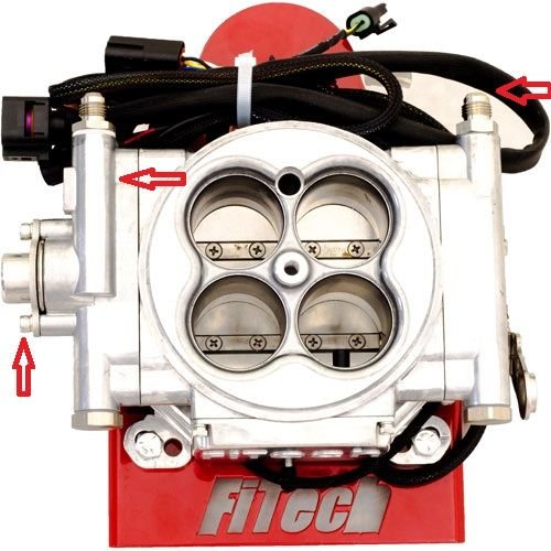

haven't completely finished trying to make the stock snorkel cleaner fit, but I don't think there is anyway possible for it to work. Here is where the stock cleaner is hitting. now i have to find a solution.....nothing on this dang car has gone easy

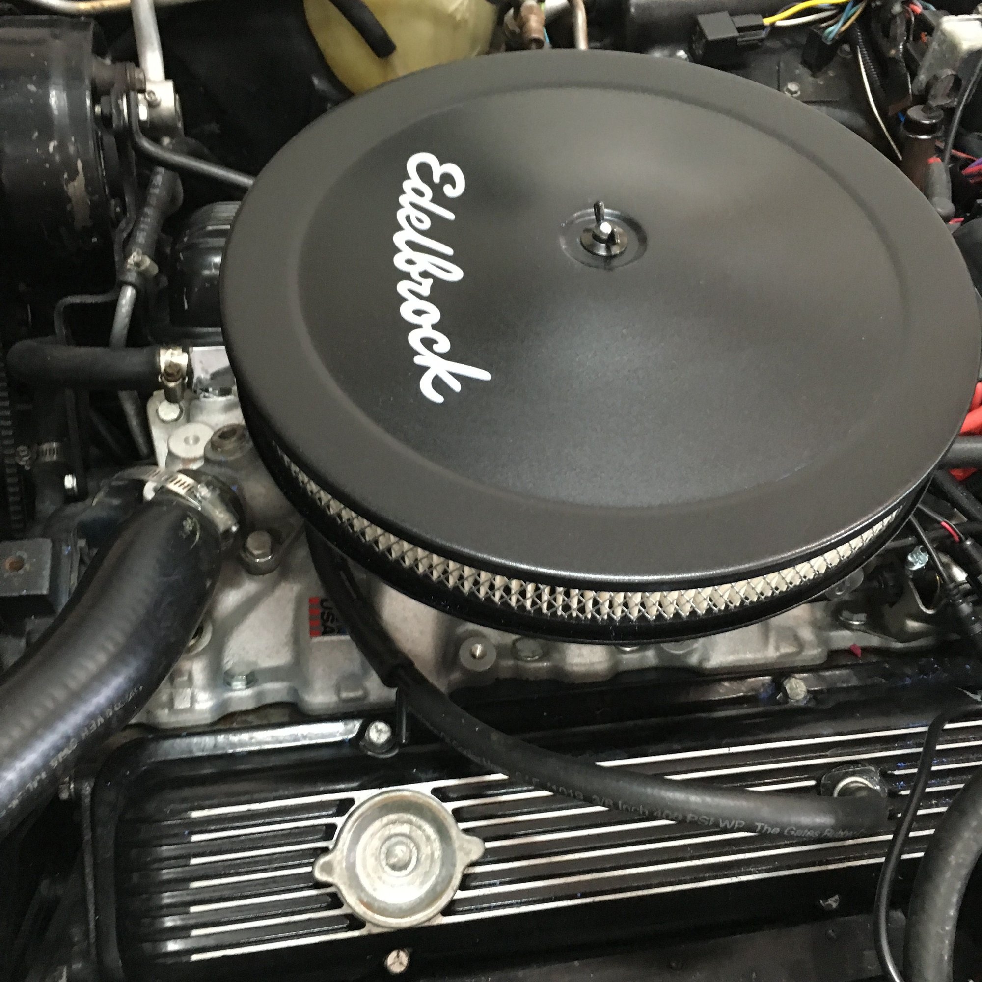

ok, just to update you guys following this I found a solution. It's not perfect, and almost hits the distributor but it works. Here is what I used:
Edelbrock Pro-Flo 1223 filter housing. The drop base has a couple of notched out areas that just barely cleared the areas I marked in the above picture. the housing came with a 3" filter but of course that wouldn't fit under the hood so I purchased a mr. gasket 1480A 2" filter.

I'm glad it fits, but it seems like a 2"er would seriously restrict flow; no?
Adam

hi Adam, i was concerned about that also, but did some research and most of the information i received said it was no problem. Might have to change it more often, but I rarely actually drive the car so that shouldn't be a big problem. I'm going to watch it and if it becomes an issue replace it with a K&N high flow filter. Good luck with your conversion and let me know how it goes. Just in case you are interested, here is my journey with my 79. I'll be posting updates to the EFI on this one

Thanks for the pictures! your second base is exactly like the one i ended up using. One suggestion i would make would be to use a 45 degree fitting for the fuel inlet on the FiTech so that the fuel line isn't in the way of the base. I used the straight fitting and will have to change it because it hits the base and will probably be a long term problem. keep me updated on your progress and good luck!
