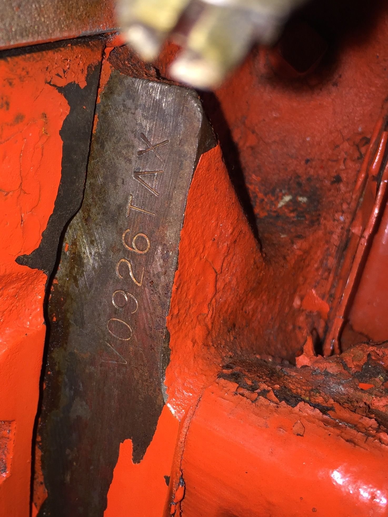

Looks like a little more cleaning revealed another letter: V0926TAX

The stamp now reveals:
V…..Flint Engine Plant
09….September
26….26th day
TAX..Suffix Code. 1970 (255 h.p.) or 1972 (170 h.p.) truck engine
Have you cleaned the paint off the rest of the pad? That's where the vin stamp would typically be.
