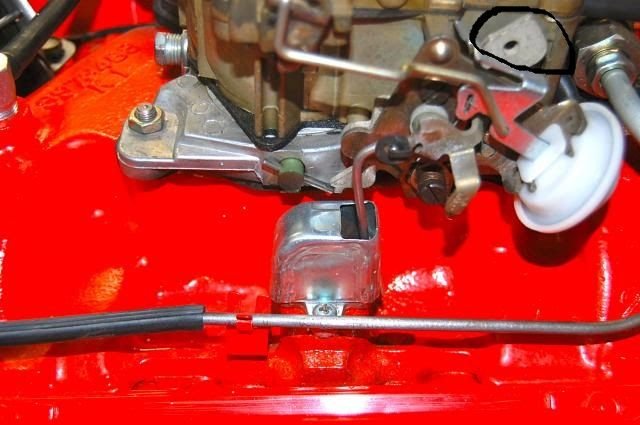

The rod (black) must be attached to the small lever in the carb body that's on the INNER END of the shaft (white).
Check that when you pivot that linkage the rod moves and closes the choke vanes.
You can feel it if the rod is loose and not in the hole in the lever.

OK, SO I WENT AND LOOKED AT MY CARB ALL OF THE LINKAGE IS CONECTED, WHEN YOU PULL THE THROTTLE BACK THE FLAP MOVES AND DOES NOT STAY OPEN THE PART THE I HAVE CIRCLEED FROM ALAN'S PICTURE MOVES BUT NOES NOT KEEP THE FLAP OPEN, I CAN PUSH IT DOWN AND THE FLAP WILL STAY OPEN. ALAN THANKS FOR THE GREAT PICTURES AS ALWAYS

First the choke coil…. when the engine is cold the coil is tight and pulls the rod DOWN.
That moves the linkage and the choke vanes CLOSE. The 'link/lever' you circled is UP. The linkage holds it UP, if installed correctly you can't push it down with your fingers.
Then engine warms… the choke coil unwinds and pushes the rod UP.
Nothing happens until you move the accelerator linkage on the left side of the carb. AS SOON as that linkage moves it releases the 'link/lever', and it's weight (that's why it's shaped the way it is) makes it drop down which OPENS the choke vanes.
In the last picture you copied the the 'link/lever is UP and the choke is CLOSED.
In an earlier picture you can see the link/lever is DOWN and the choke is OPEN.
You can easily install the link/lever incorrectly so it works backwards.
Maybe?
