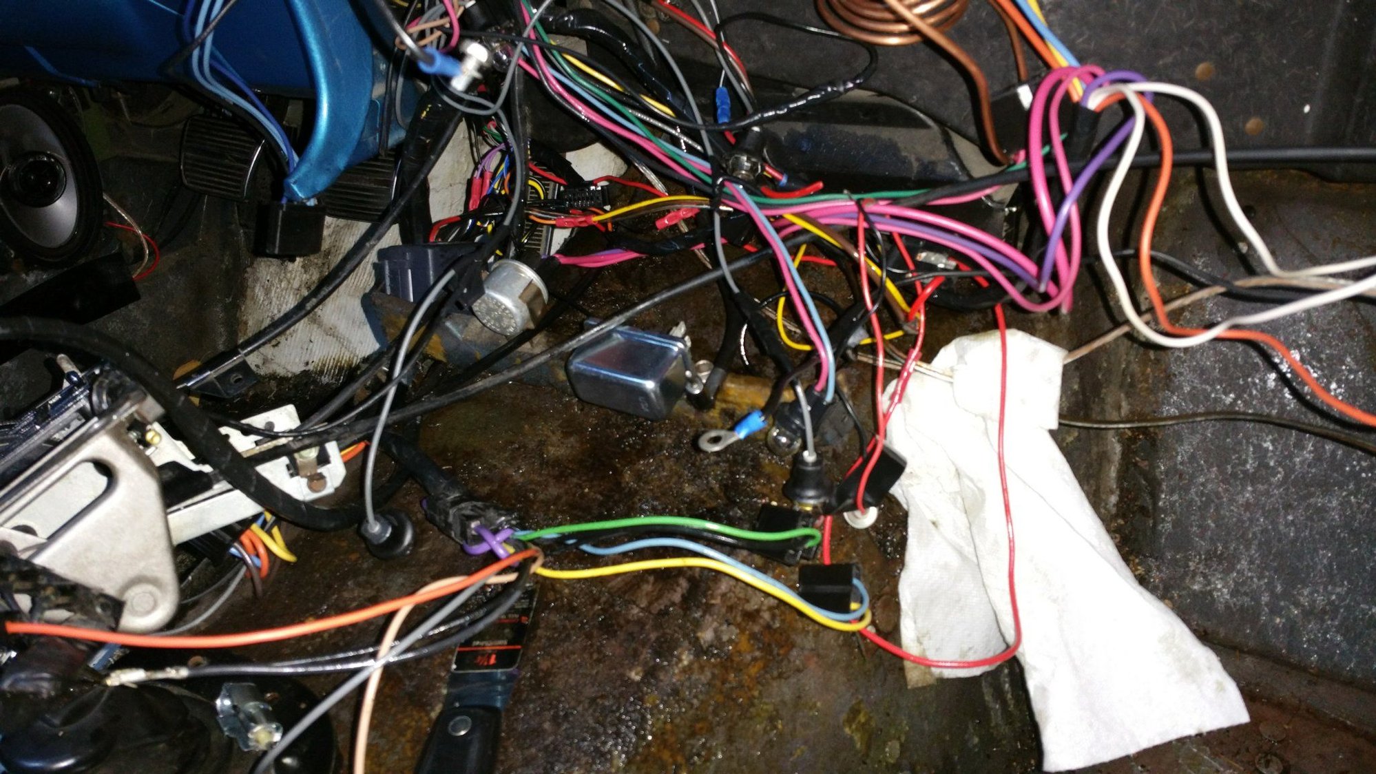

Hi 69,
Here's the location of the flasher unit and the capacitor for the radio on my 71.
You can see the clip that holds it is mounted to the dash pad.
Regards,
Alan
The camera is point the same way the arrow is in my first picture.
