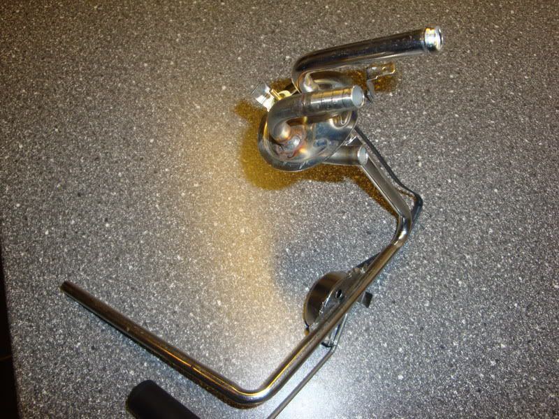

How to connect the return fuel line to the stock tank setup?
This is how I did it.
