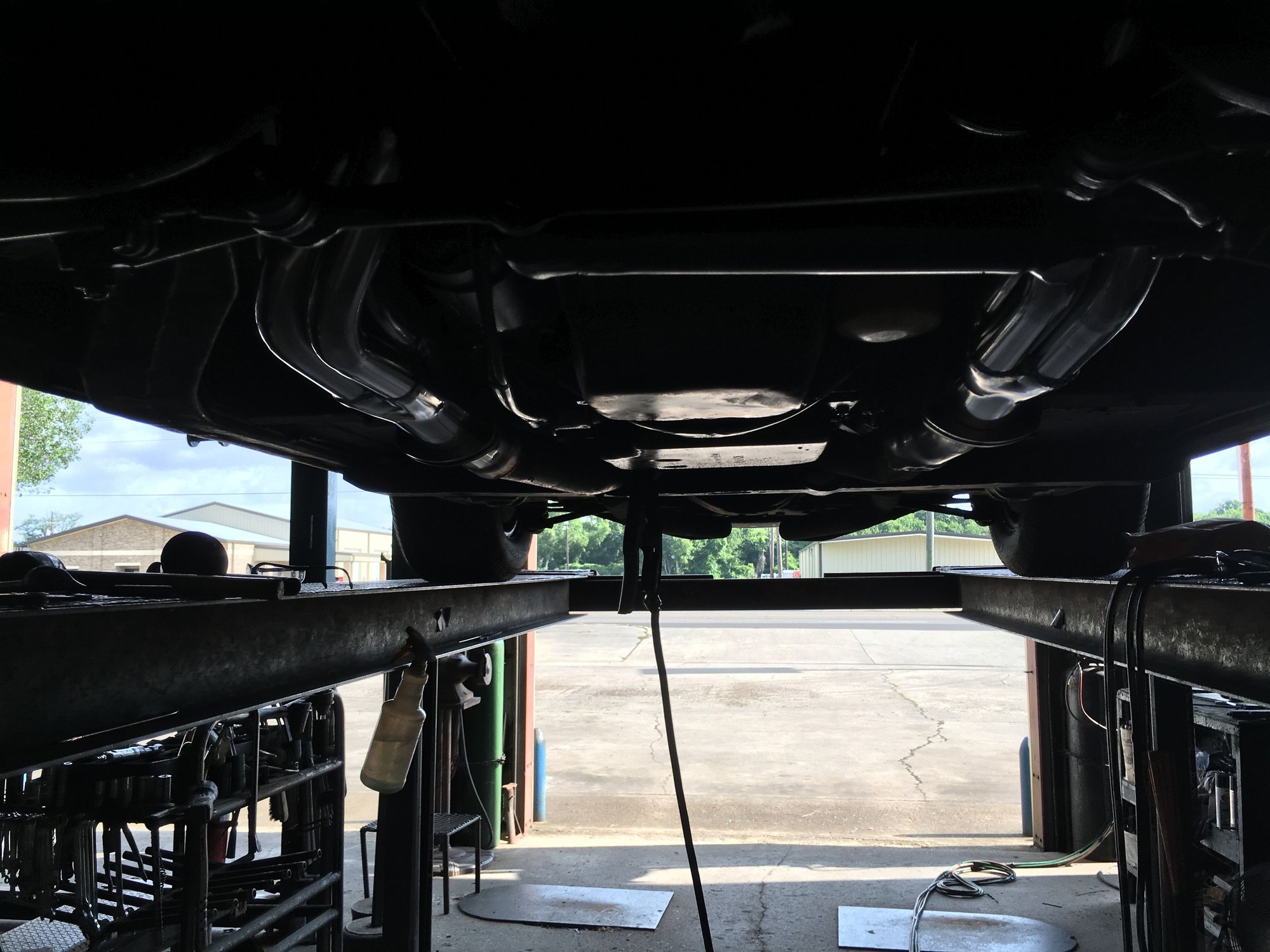

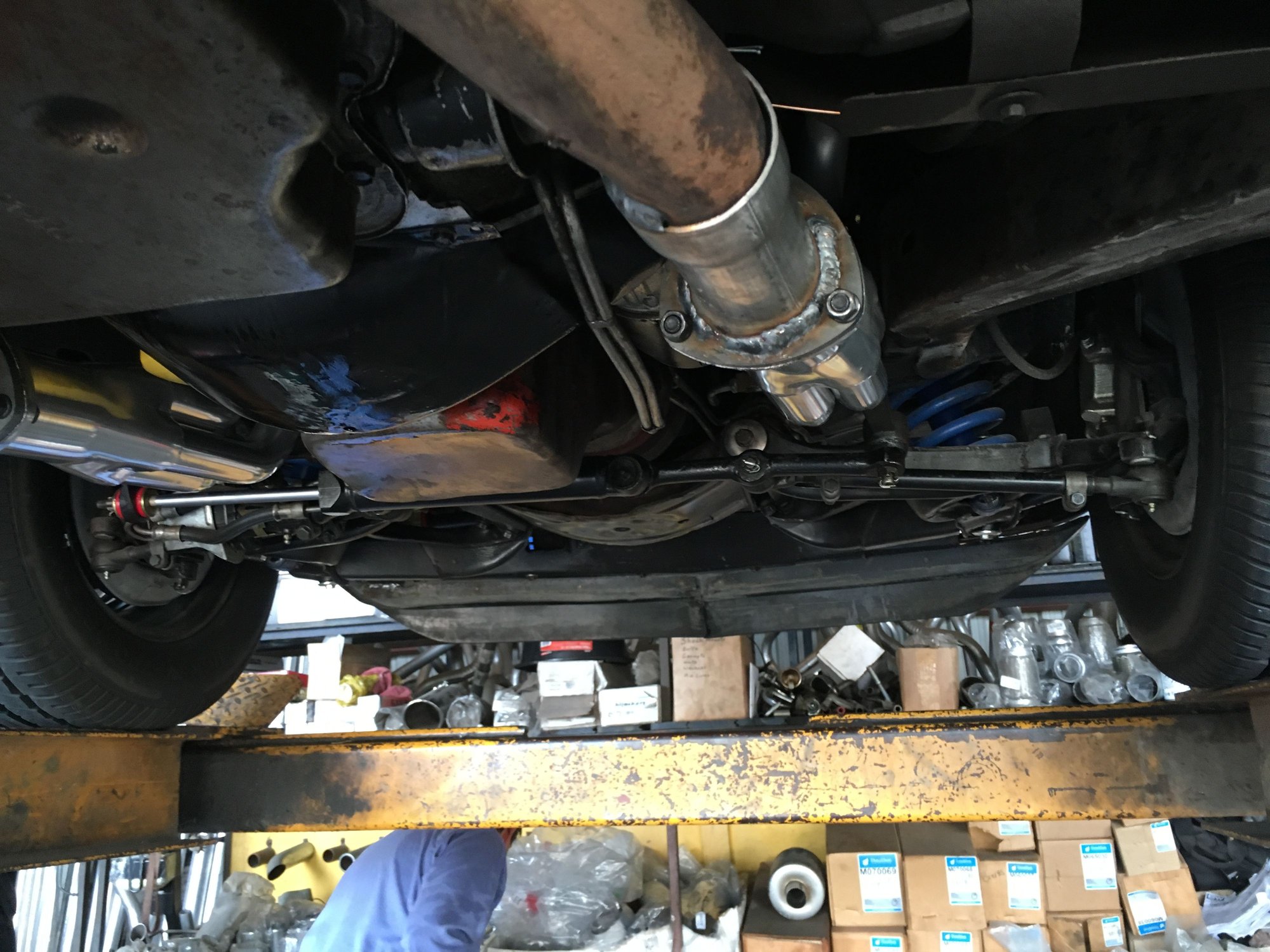

I just bought Flowtech Ceramic coated because plans call for engine swap with Angle plug heads. Here they are being connected to my exhaust pipes . They tuck up pretty well
To Header Help
